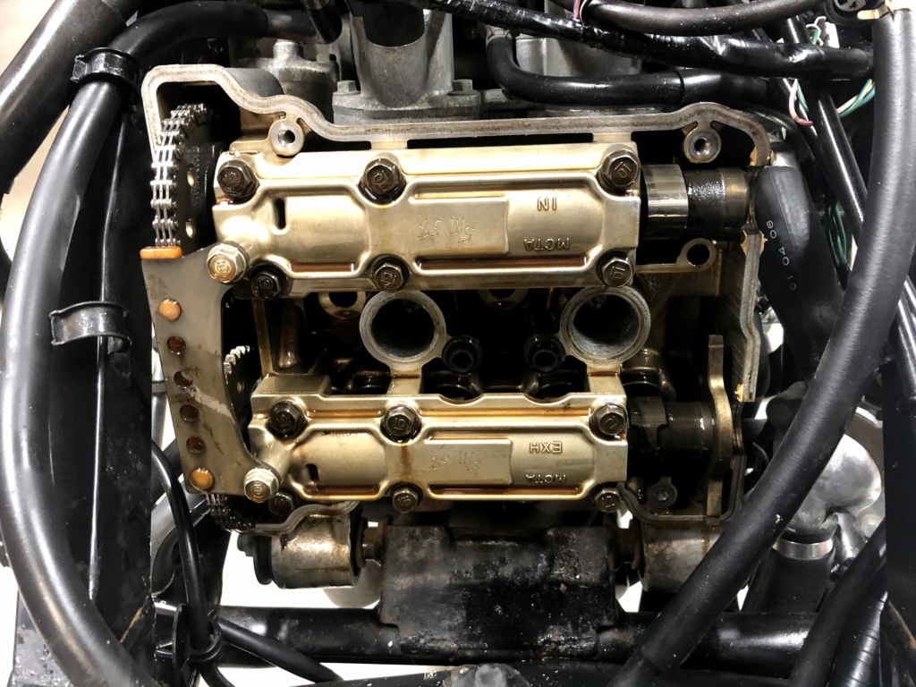

PostSubject: Re: possible top end rebuild needed at 60k   possible top end rebuild needed at 60k I_icon_minitimeThu Dec 03, 2020 8:25 pm
possible top end rebuild needed at 60k Img_1210
Once you get the bodywork off, the plugs and cam cover are pretty quick and then you get access like this. You can even see the edge of all four exhaust cam buckets. VFR owners can only dream of easy access like that...
