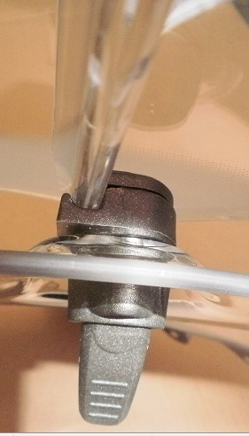

| Hi, I was given the opportunity to test the new Givi Adjustable Windshield for a review. They sent this to me on June 30th which was just a day after I spoke with the Givi representative. This will be a shorter review since I only put about 50 miles on it with my initial ride. But I did go on the interstate, state roads, and the city. And I also tested it out in the lowest, middle, and highest postions in all of roads. PackagingThe windshield was very professionally packaged. There were 2 smaller boxes in 1 larger box and everything was put in where it would be very difficult to damage anything on the shield. And all of the parts needed were in there, although there really isn't much that is needed. Pictures of Shield  I removed my Givi Windshield that I cut down about 1 1/2". Measuring from the handlebar cover to the top of the Givi screen I cut down was 20 1/2" (measured from the Honda emblem on the handlebar cover). After I installed this Adjustable Givi at the highest position it measured 20 3/4", so it is about 1/4" of taller than the Givi that I took off. The parts of the shield seem to be very sturdy and easy to use. Here are a couple of close up shots of the fasteners. I'm am calling them fasteners but Givi may refer to them by a different name.  The RideI started the ride with the screen in it's highest position which allowed my eyes to be about 1" to 2" above the top of the screen. I started on the city street to ride out to the interstate about 1 1/2 miles. I merged onto the interstate and quickly got up to 65 mph (all speeds will be actual in this review) and I didn't notice any buffeting whatsoever. The top part of this windshield seems a bit narrower than the stock Givi shield but it seems a smoother ride without any turbulence at all. I think the gap between the screens really helps out to eliminate buffeting or back pressure. There was no back pressure that pushes your body or helmet forward at all. The single piece Givi shield that I removed would give a small bit of back pressure that would push your helmet or even your body forward a bit. But there was none of that with the new Givi Adjustable shield. I rode up and down the highway in about 3 mile sections to try out the different height adjustments. I started out in the highest postion. INTERSTATEHighest PositionIn the highest position it was a nice quiet ride like the single piece (original) Givi shield. But it seems to be a smoother ride since there is no turbulence at all. I ride with a 1/2 helmet with the fighter pilot visor and when I raised my visor all the way up I didn't feel the need to have to wear glasses at all. Except for safty issues. I don't feel comfortable at all riding without some type of eye protection. But I wanted to test it out to see if glasses are needed. Well, they aren't. I felt a very small amount of wind/breeze but I think it was from some of the wind that came from the side or from around the shield. I raised my hand up to see where how far the wind was being pushed up and it was at the top of my helmet. It seems that it pushes the air up about 4" over my eyes and gave absolutely no buffeting at all at 65 mph. I also tried to ride close behind semi-trucks and also to the side of them to see if I felt any of the "sailing" effect that I would get with the single piece Givi shield. Sometimes if the wind was right I would feel the wind catch the shield and give some turbulence or that "sailing" effect. Well, as much as I tried I couldn't get that effect with this new adjustable shield. Middle PositionI then rode with the shield at the middle positon and I did find a bit more wind hitting my eyes but not much more than at the highest position. It was also pushing the wind to just an inch or two below my helmet but there was no buffeting at the middle position either. It seems to push the wind in a very friendly manner. I also didn't get any of the turbulence or buffeting either at the middle postion, even when trying to ride close to semi's. Lowest PositionThe lowest position would give me more wind, of course, but it was still a smooth kind of effect. Even though the lowest position is probably close to the height of the stock Honda screen it didn't seem to produce any buffeting, that would cause my helmet to be pushed around. The stock screen would push my helmet around pretty bad on the interstate but this Givi adjustable screen didn't do that. As a side note: I'm 6'0" tall and when I sit on my SWing in my normal riding position my eye level is 31" from the seat. I have a longer torso than an average 6 footer so I was concerned that this adjustable shield may not be tall enough. I have to say that this windshield on the interstate is a very nice shield that produces a nice smooth ride. There is no turbulence or buffeting at all, even when trying to ride as close to semi-trucks as I could to get that effect. I also didn't notice that "sailing" effect that I would get with the stock Givi or the XL Clearview that I had on at one time. STATE ROADHighest PositionThe state road that I road on had a speed limit of 45 mph and it was in very good condition with nice curves on it. I started out with the screen at the highest position and it was very smooth. I didn't really keep it at this height for very long at all. It was about 80-85 degrees there so I pulled over to adjust it to the middle position. Middle PositionI pulled over and adjusted it to the middle position and rode about 5 miles this way and it is a very smooth ride too. Since the speed limit is only 45 mph it is really nice to have the option to adjust the screen. It felt like a very relaxed ride and gave more wind to my body which helped make the ride more enjoyable since I could stay cooler. I then pulled over to adjust it to the lowest position. Lowest PositionI rode about another 5 miles with the screen in the lowest position and it was also a very nice ride. I think this is the height I will have it at when I ride on these types of roads at these speeds. When I would raise my visor I would feel more wind, of course, in my eyes but it wasn't alot. But it provided a nice breeze to my body and face and it still didn't produce any buffeting to my helmet/head. It was really a very nice ride that kept me cooler. I also rode one part of my ride on a 5-6 mile stretch where the speed limit was anywhere from 15 mph to 45 mph due to the tight turns. I started the first 2 miles at the middle position and then dropped it down to the lowest position. With this type of ride it was very nice to be able to adjust the shield. Since the speed was slower, and it was hot out, this made the ride much more comfortable. Adjusting the Screen:As for adjusting the screen...it is very, very easy and quick. I would adjust it at stop lights or stop signs and it only takes about 5 seconds. It is just that easy. I wouldn't try to adjust this as you ride but I guess it would be possible, but not very safe. You really need to use 2 hands to do it quickly and safely. Conclusion:I know I only went on about a 50 mile ride but I have to say I like this new Givi adjustable screen more than the other screens I have had. I don't know if it is the "air-foil" or what, but the ride was very smooth and without any turbulence or buffeting. Even at the lowest heights I still didn't feel turbulence or buffeting. I know that there was more wind at my face at the lowest setting but the wind didn't push my helmet around. It is hard to explain but this shield seems to push the wind up a good amount of distance. When I had my Majesty I put a Laminar Lip on the Givi shield I had and it did help. I think that this shield gives that effect of the Laminar Lip but to a much better extent. I will give additional updates but if I were in the process of buying an aftermarket screen this is the one that I would choose. I think that if you are a bit over 6' tall it will still do a good job for you. I'm not sure how it would do in the rain so I can't comment on that but it doesn't rain much out here in California. I can say that when I am in the hills/mountains and on some nice curvy roads I will be keeping it down in the lowest positon, if it is warm out. It is really nice to have these options available to you when riding. The highest position is great on the interstate but I think I will be keeping it in the lowest or middle position in the city or out on my country rides. Here are some more pictures:  This how the screen fits into the fastener.  This a side view of the screen at the highest level.  This is a picture at the lowest setting. My eyes are probably 5" over the top.  This is the screen at the highest level. My eyes are 1" to maybe 2" over the top. I would like to thank Givi for giving me this opportunity to review this new shield of theirs. It really is a very nice shield and gives the rider the ability to adjust the screen as needed. If you have any questions please reply to this post and I will keep them in mind for when I give updates. I'm sure i forgot some things so please just respond and I will do my best to get you an answer, if I can. Thanks for reading. "edited on July 5th" I'm not sure who all sells these but I have seen them on www.scootertrap.com and I know Matt is a great guy to deal with.

| Jeff i just mounted my Airflow, Like you said very well thought out. I will be trying it out on Sunday on a fairly good ride I also had a Givi standard and cut it down about 2.50" And the reason I bought the airflow was to try and eliminate neck strain.I have never had that problem before no matter what kind of bike I rode And your install picture of the standard shield works on the Airflow also. I just can't seem to upload a pictue to a post But there is one of the Airflow in my Album Tony |

| Hi Bigbird,
Honestly, I've not noticed any kind of buzzing or noise associated with cutting off the tabs. I just got so sick and tired of trying to fuss with getting it off that I simply decided it was time for the tabs to go. The screws do a great job of holding it in place. I think you should be fine if you cut the tabs off. You will be a whole lot happier and less frustrated come time to change the windshields. Even if by chance you do happen to notice any noise or vibration, you could always use something to "dampen" it such as adhesive backed foam or something similar. But I think you'll be fine though as I've never had any noise problems. |

 | Subject: Re: Givi AirFlow Adjustable Windshield Review Wed Jul 21, 2010 9:47 pm | |
| I never thought about cutting off the tabs but I can usually get mine off in just a few seconds though. I lost my screws somewhere and only the tabs are holding it in and it doesn't rattle either. |

| I'm delighted to say that my windshield arrived today from the US - it's taken about 10 days but I've got it at last.
Looking at the instructions (which are barely readable!!), it looks as if I've got to drill some holes before fitting. Did you guys drill anything? I don't remember reading anything about that in the 'pictorial instructions' or your posts.
If that's going to be the case, I may take it to my dealer to get it fitted - I don't trust myself to do it !!

| Laurie you are right the instructions have a lot to be desired.The reason for drilling the holes is for the 2 mounting brackets A good number of Swing owners do not mount the brackets, So no drilling and it has been fine. Now what I found out from all the good info. here Is that Givi and Honda had a love affair at one time The Swing was made to except a lot of givi after market Acc.So when you mount the brackets with existing bolts There is a place for 2 more bolts on each side If you drill about 3mm deep at these locations just thru the plastic there are 2 capture nuts under the plastic I used a drill bit slightly larger then the bolts that came with your shield. Reason you get confused is the instructions don't tell you why you are drilling and that the nuts are already there. I mounted the 2 brackets I think it makes it a lot stiffer If you are still a little leary about doing it you can take it to a Dealer But they might know less than you Tony |

| I just mounted it like you would mount a stock shield...didn't drill any holes and it's fine and very stable...less flexing than any shield I've used before. Jules...Warrenton, VA |

| Laurie, I tried to use the metal strip but just put it aside since I didn't use it on the standard Givi shield either. And like Tony said, the dealers sometimes don't know anymore than the average SWing owner so you may want to try to do this yourself. There is a "Pictorial" that should help you out in the "Pictorial" section. It should only take about 30 mins the first time you do this. |

| Well, I managed to fit the screen yesterday. It took me about 45 minutes without losing any screws, washers, grommets or breaking any tabs!! Took it out for a test run and, my goodness, what a difference it's made. It's quieter (I can hear myself think!), not much buffeting at all and even in the slip-stream of trucks and cars it felt much more stable. What I love about it is that it can be adjusted by millimetres. I was afraid that it only had 3 settings (bottom, middle, top), so I have it set exactly where I want it. Thanks again for all your tips and help guys. Couldn't have done it without you!! Laurie |

| For those of you that did not drill the plastic I'm here to tell you it's not a big deal.
When you mount the stainless plate without the shield in place and drill thru the plastic all you are doing is exposing a pre drilled / threaded boss in the steel frame that holds the entire front fairing to the scoot.
Light pressure on the drill and the plate for a guide will put you on the mark to use that third mounting point.
BTW .... Stress cracks in the future or miss drilled holes now will set you back the price of a new front nose piece .... $320. to $370. depending on the year and or color. |

| - trouble1100 wrote:
- For those of you that did not drill the plastic I'm here to tell you it's not a big deal.
I second that. Also, it's not necessary, but if you want to have a better view, I seem to remember that that black plastic piece (the one that sort of forms the dash/top of inst. cluster) comes out with just a couple screws and clips, and then you can see the nut and exactly what you're drilling into. |

| Bigbird, how obvious is it where to drill the two holes? |
