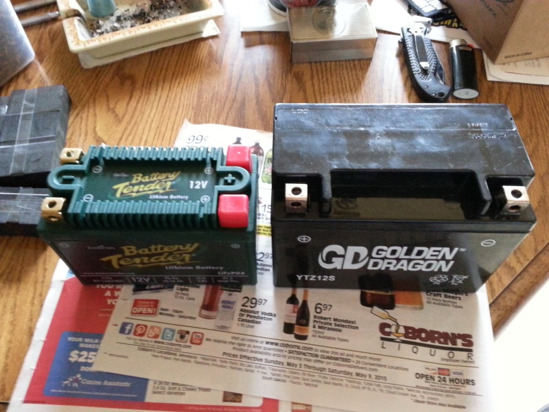

| Hi John, I put a Battery Tender Lithium Ion battery in mine last season. It's lots smaller and weighs 1.75 Lbs with 240 Cranking Amps. It cost me around $100 from Amazon dot com. I also have a Battery Tender charger and put it on about once a month during our winter. It comes with self-stick dense foam spacers to take up all the empty space. I haven't had any problems with it. It also has two + and - posts so you can hook up any accessories if you want. |

| I recently read a post from a rider who installed a lithium battery. Lighter, smaller and just as powerful as an OEM. I have an OEM battery only about 6 months old, but I plan to replace it with a lithium when the time comes. |

| Hi Kenjj50,
That was probably me with the lithium battery. I put it in last spring and also have a Battery Tender Jr charger that I put on about once a month to maintain it. The SWing does draw a small bit of juice just sitting due to keeping the computer, or whatever you want to call it, active. In Minnesota we don't/can't do a lot of riding during the winter months, probably similar to where you live.
I also have this battery in my 1974 Honda CB750 and it cranks that over very nicely. I don't have to keep that battery maintained due to the 750 not drawing any power when shut off. |
