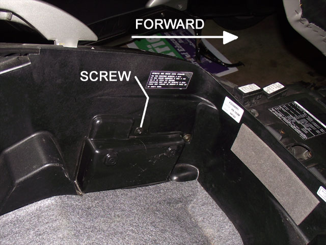

| I know this might sound trivial but I'm getting my Swing ready to sit the winter out and want to put a trickle charger on it. I removed it from my Reflex and I guess I assumed the battery was as easy to access on the Swing but after taking off the panel under the seat I still don't see it.
Can anyone help?

It's in the left side of the cargo area under the seat and you need to remove the battery cover, just one screw.
Do you have an owners manual? |

| It's on its side, too - that confused me at first. |

| Battery location is shown in the Owners Manual. As a professional writer I feel obligated to point that out. Setting the obvious aside -  Remove the single screw that is called out in the image above and remove the cover to reveal the battery. The positive (red +) connection is forward and the negative (black -) is aft. |

| The info given by jdreereanton is important to note, since the pos and neg terminals may be not so easy to identify after you take the battery cover off (the + and - indicators are on the cover). If you reverse the cables or hook up the charger improperly you could do some real damage. I don't know why Honda didn't make things a bit easier, such as providing small wires leading out of the case for easy charger/tender hook-up. |

Good point. In fact that is exactly what I did to ensure I could hook up a charger without removing the cover. |

I ran 2 10" wires from the battery to a 12v (Cigar lighter) & glued it beside the cover. I can charge my cell ph.-gps- or plug in my battery charger or trouble light. Works for me harley |
