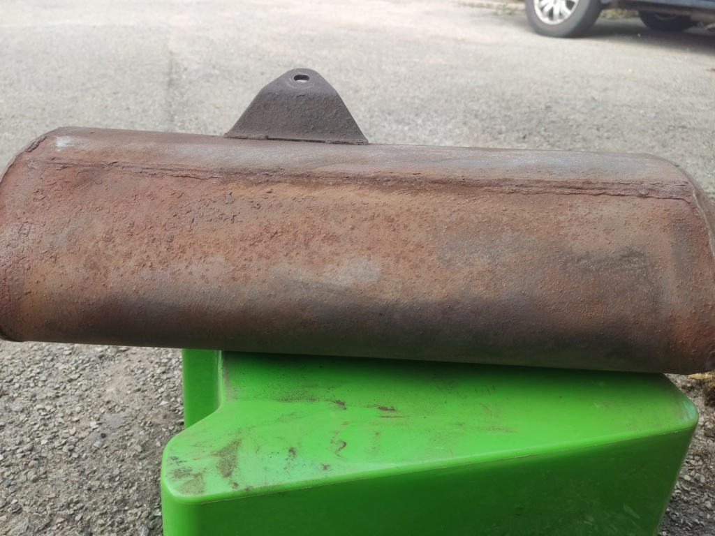

Here's the condition it was in initially:
Exhaust paint Img_2013

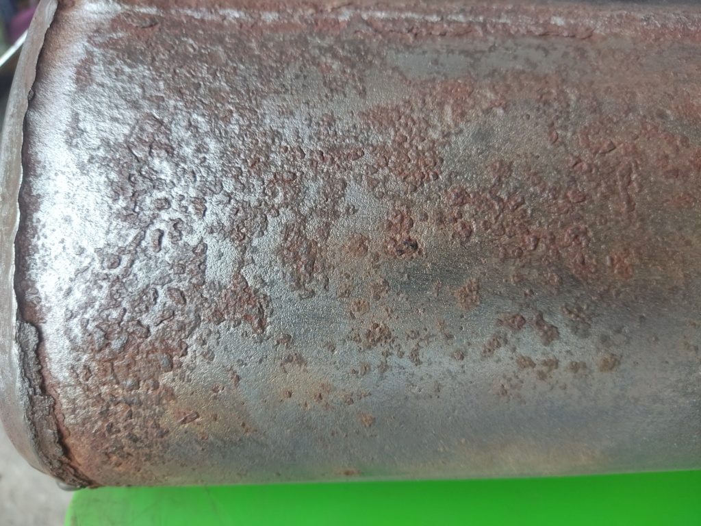

And here it is after brushing:
Exhaust paint Img_2014
My question is, should I remove all these small dark areas before painting? The color doesn't seem to be rust; does anyone know if it's old paint that would provide good adhesion for the new paint? it's taking me quite a long time to get down to the bare metal, I using a drill with a wire brush attachment.
Here's a close-up view of what I mean:
Exhaust paint Img_2015

PostSubject: Re: Exhaust paint   Exhaust paint I_icon_minitimeMon 11 Sep 2023, 21:03
Honest answer: I suspect with that degree of rust (and I do suspect the brown is rust actually), if you try to smooth it all out pre-paint, you may wind up with a lot of holes in the muffler wall (those raised areas may be indicators of severe corrosion in the muffler wall). It may be a better idea to forego this any maybe get an aftermarket exhaust, like a Delkevic.

Yusepe wrote:
affraid
If I paint over it, wouldn't it adhere?
Answer is yes (use high temp primer first before topcoat of high temp exhaust paint), but it won’t be smooth and likely rust will eventually come through again.

PostSubject: Re: Exhaust paint   Exhaust paint I_icon_minitimeTue 12 Sep 2023, 05:18
TBH the only way your going to know if the muffler is worth saving is to take a flap wheel grinding disc to the rough corrosion and smooth it flat.
This will show up any perforations(pin holes) and also prepare the surface for a re-paint.
I have had very good results on all types of exhaust pipes using a Simoniz Matt VHT silver/black paint protects up to 800 C, available from Halfords(UK shop).
It comes in a spray can form, no need for a primer, and can be applied with a brush for seamless results. Just remember to give it a very good shake up before use. Clean brush after use with a brake cleaner spray.
