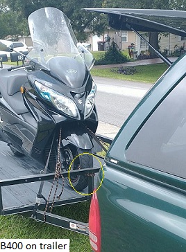

Personally, I don't like using straps on the end handlebars, especially on longer/higher handlebars used on scooters or touring bikes, seem plenty bent ones from doing so, not to say cracking/breaking off the formed aluminum ones on other bikes, just got to hit the right pothole or bump and you could cause damage, with luck you won't drop  bike in trailer  Shocked
If I can't strap on the lower handlebar bend close to triple clamp, I try strapping to lower triple clamp. The only time I trailered SW600, when I picked-up from dealer, it took me a good 20 minutes to figure how to safely strap it down. I used a non-motorcycle utility trailer with no wheel chock, tied wheel to front rail with nylon rope, strapped down at lower triple clamp and rear points, no issues for 125 miles. Ditto for my B400.
Transporting a Silverwing in a trailer (Tie down locations) Burg410
Transporting a Silverwing in a trailer (Tie down locations) Swfork10
