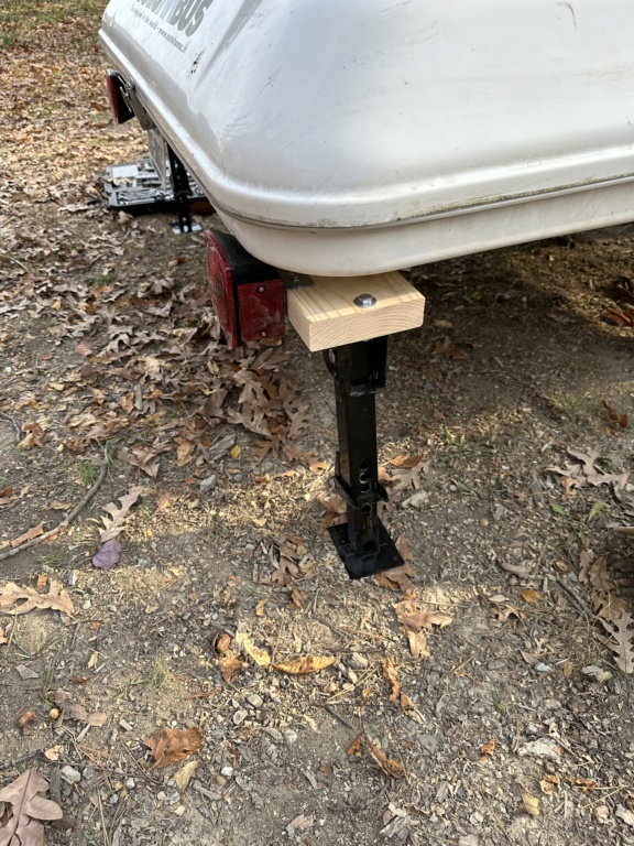

| I brought home this titled used mini motorcycle trailer this week. With the wheels and fenders, the frame area is approximately 48”x48”. I’ll extend the tongue 2 feet and build a 6.5x4’ foamie camper with it, with an aerodynamic shape. It only weighs 95lbs. With a base floor and the foamie camper construction, I should easily come in at 150lbs or less.  |

 Build pictures please. Be glad to. The trailer frame itself is smaller than I originally thought, 30” long and about 44” wide, including wheels and fenders. I’ll be adding 3 feet to the 4’ tongue and shooting for a 6’4”x4’ footprint. I’ll use 1” or 1 1/2” xps foam to save weight and I’ll probably go with a curved semi aerodynamic design for the roofline, sloping up to a height of about 4.5’ at the rear. It will be a rear entry, but I haven’t decided on the exact design yet. And I still need to figure out a lightweight but strong floor. |

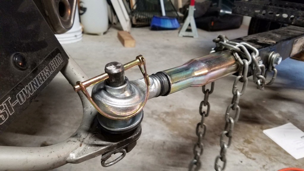

| I just found a diy swivel hitch explanation. It looks to be a quite satisfactory version of a Helm swivel hitch for a small lightweight motorcycle trailer: https://motorcycle7usa.com/question/diy-heim-joint-swiveling-hitch-coupler-no-welding/   |

 | Subject: Re: Does anyone pull a trailer with their Silverwing? Mon May 02, 2022 12:22 pm | |
| Does that hitch have 360 degree capability? You might be surprised what can happen when you drop a trailer wheel off the pavement. |

 | Subject: Re: Does anyone pull a trailer with their Silverwing? Mon May 02, 2022 12:24 pm | |
| Gosh! It looks like an enormous rose-joint! Does the job, though.  |

 | Subject: Re: Does anyone pull a trailer with their Silverwing? Mon May 02, 2022 2:22 pm | |
| - john grinsel wrote:
- Does that hitch have 360 degree capability? You might be surprised what can happen when you drop a trailer wheel off the pavement.
Yes, in addition to the limited rotation provided by the end of the tractor top link where it sits on the vertical pin that is the “ball” for this hitch, the greased threaded neck of that tractor top link will spin 360• within the body of it within the tongue. It could spin 360• several times, actually, though it’s obviously not on a bearing. |

- Gosh! It looks like an enormous rose-joint!
Does the job, though.  That’e essentially what it is, plus the threaded part freely spins within the body of the tractor top link. I just picked up a 12’ piece of 2”x2” 11g steel square tube to extend the tongue 3’ plus make a 4’ cross piece for on the tongue to support the camper. |

 | Subject: Re: Does anyone pull a trailer with their Silverwing? Fri May 06, 2022 6:12 pm | |
| Now to figure out safe hitch that does not go up and down with rear wheel, remembering ball should not go up and down with rear wheel....hitch height has something to do with behavior underhard braking. |
