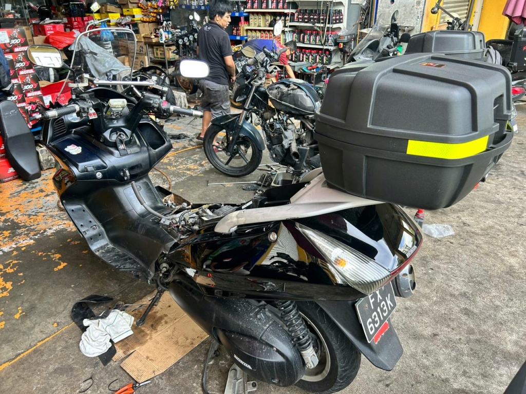

After 5 months of fixing my poor girl up, it has finally died on me..
I noticed brown liquid pouring from the left side of my Swing. Also noticed the overheating light bulb on as well. I thought I could manage by riding it slowly to my regular workshop 20km away. Unfortunately, by the time I reached the workshop, all I could hear was knocking, harsh engine vibrations, and a plume of white, sweet-smelling smoke engulfing my Swing.
My Silverwing has finally bit the dust...  Swing10
My Silverwing at the workshop. By then it has stopped spewing white smoke from the engine area.
Figured maybe a coolant rubber hose broke somewhere suddenly as well. I am sure I messed up my engine gaskets and will probably have to do a full top overhaul. Here's to hoping my pistons didn't overheat...

Shocked Gulp… this is not good. Happy to hear that you were able to limp to the shop. Hopefully the issues won’t be too budget-shattering to resolve.
Please keep us informed.

Sorry to hear that you should have parked it and not kept riding. Overheating an engine does a lot of damage to internals knocking not a good thing bearing damage. Have them check the compression first if very low don't put money in it better off with a used engine.

Unfortunately, internal engine parts for the Silver Wing engines are no longer available from Honda. So if it has internal engine damage it is unlikely it can be repaired and will need a donor engine.

Ebay might be the only way it fix tour scooter.
More often than not, just swapping out the motor is much less expensive than paying labor to teardown and inspect and repair. Good luck.

Just dropping a photo of my Swing stripped down to its engine. The mechanic working on it is the same mechanic who helped me to rebuild my starter motor back in mid-May.

Regardless, great news! I've finally got my Swing back from the workshop. Spent a total of SGD600 (That's USD422).
Not exactly sure what was done (the workshop's boss was not in, and the mechanic who magically got my Swing back in tip-top shape left already) but I'd imagine the following was done:
- replacement of head gasket
- replacement of coolant hose
- coolant change (expected)
- full synthetic engine oil (expected and definitely overdue)
- labour (I dropped my Swing off at the workshop on Thursday; the mechanic worked on it through the weekend)
I've also noticed that the mechanic who worked on my Swing also helped to tighten my brakes. That is something I did not tell him about but it was an issue I had grown used to. If anything, I thought that was pretty solid "value-added service".
I'm dropping by later to get the receipt from the boss of the workshop. I'm just very thankful that the same mechanic who troubleshooted and repaired my starter motor within 2 1/2 hours in front of my eyes managed to work his magic and get my dear Swing up and running again. Definitely owe that man a drink!

That is great news. I've overheated my SW twice. Both times in summer and both times threading through standing traffic, hence, didn't notice the temp gauge or warning light until coolant started pouring out from the pressure cap.
The first time was due to an air lock and the second time was a fan motor relay failure. I didn't have any strange noises from the engine though.
Anyhow, the old girl doesn't seem to have any lasting damage from my negligence.
I hope yours hasn't either.
I didn't notice that I was overheating either because I was so used to the sound of the radiator fan spinning. I hope so too! The downtime my Swing spent in the workshop made me realize that I have some sort of attachment issue to it. Perhaps it's a first-time bike ownership thing. Laughing
Congratulations on the repair. I don't know the exchange rate but that sounds like a bargain price, BMW would charge that just for writing the invoice 😏
Thank you! I thought it could have been slightly lower, but given the fact the mechanic painstakingly worked through his weekend to have my Swing up and running, I'd gladly pay up. And yes, I'd imagine the actual repair cost for BMW would cost an arm and a leg! To think my end goal was a R1250GS...
