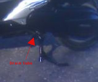

I don't have a great picture of my drain tube but it is visible from the left side. It is just behind the side stand and just in front of the center stand. The tube is transparent, pinkish in color on my SilverWing. It has a black plastic cap held with a spring clamp on the tube.
Dumb question: where is crankcase breather plug? Drain_10

Thanks, it was the plug I wasn't sure about it. Can you also tell me what the other clear tube is located behind the crankcase breather?
I'm not certain in the SilverWing but on other Honda cycles, there is a drain from the airbox itself. Its not part of the carnkcase breather like the drain tube but it allows for moisture to leave the airbox
