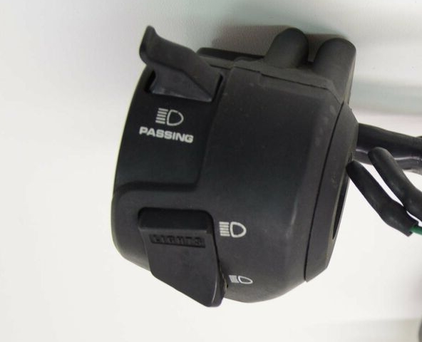

I've posted a similar post on the SilverWing FB group, but i guess here is where the real experts are:
So ever since i got my Wing here in the US i felt like something is missing on my left hand controls.
A short search today made me realize that the US version of the Wing was not only missing the factory 12v socket in the glove-box, but also the "Passing" light switch on the left hand switched stock.
For anyone who's not familiar with the "Passing" light, this has the same function like the blinking high beams on a car - it toggles high and normal beams momentarily (vs. the top switch the toggles them permanently)
Anyone here has any expirience with retrofitting a non-US lights switch stock on a US Wing?
Attached is a picture of a European lights stock with the said "Passing" light switch"Passing" lights switch? Pfa10

I'm a big fan of those passing lights in that particular location by my forefinger. Newer bike seem to have relocated it to the hi/lo rocker being a push down from the lo position, which is not as intuitive (or I'm just set in my ways).
There is one extra wire in the Euro-style 9P wiring block being Bl/R which is battery power arriving. Then a link across to the Bu wire from the hi/lo switch presumably within the switch itself). Seems to me if you bought the Euro passing switch you would need to find a source of battery power (and tapping into the power to the horn Bl/Br seems easy) to feed into the extra passing switch, and then I assume the connection to the Bu wire of the Hi is within the Euro switch block.
I've no real idea why the pass light requires its own power feed and why it does not just use the Bu/W feed to the hi/lo switch, maybe to do with current drain or redundancy.

For what it's worth here's how my pass light switch works:
With 'lights off', the switch operates the high and low beams together.
With 'lights on', it operates the high beam without affecting the low beam. thumbs up

Hmm… Then how to get one of those pass switches over here? Without spending a bloody fortune.
Points : 8937
"Passing" lights switch? Empty
PostSubject: Re: "Passing" lights switch?   "Passing" lights switch? I_icon_minitimeTue 26 Apr 2022, 13:22
If you've managed to get by all these years riding a Silver Wing without one, why do you need one now?
Just between you and me Timothy, have a look on eBay uk, there's a complete left handlebar Silver Wing switch unit for sale complete with passing switch for £24.95 or $31.44 plus postage.
Don't delay or someone else will read this and buy it.   Smile

ron1999 wrote:
My '06 had it, my friend's 08' has it - i believe it's all non-US that has that feature.
My thoughts exactly.
I tried looking for non-US parts, problem is the the SW is not that common...
It looks like same year's CBR's and SilverWing 125cc shared the same controls, but the end connectors for the wire loom is different.
To make things even worse, it also looks like on the SilverWing they change end connectors at some point as well.
the way i see it - an adaptation will be inevitable, just dont know yet from which model and what to.

sonuvabug wrote:
FWIW - both our 2004 and 2016 Burgman 400 left hand module have switches with the flash button on the back (for forefinger use).  The module also has the horn (bottom), 4-way hazards (above horn switch) and high/low beam switch on top.  Only handy if you're looking to add the 4-way hazard function.
Oh yes! 4-way hazard switch as integral to the left switch module. Any chance you could scare up a part # for that switch module for me? I assume that the Burgys handlebars are the same diameter as Silverwing.
Number of posts : 899
Points : 5738
PostSubject: Re: "Passing" lights switch?   "Passing" lights switch? I_icon_minitimeTue 26 Apr 2022, 15:15
I believe they are both 7/8" diameter handlebars Tim.  Here's an eBay link to a used part that should get you pointed in the right direction.  I looked at their pics and it appears to be the same switch as is on our 2016 Burgman 400.
https://www.ebay.com/itm/200484596813?_ul=IN
For future reference when this link no longer works, the switch is called the "left handlebar switch" and the unconfirmed Suzuki Part number is 1392-05-0032
I also found another reference which was Suzuki "switch assy handle lh" part number 37400-14G61-000

" Any chance you could scare up a part # for that switch module for me? "
Suzuki Burgman parts are ridiculously $$$, here's Ron Ayers discount price, you can find them cheaper used on ebay. BTW the "Hazard Switch" is on the RH switch assy on my 2014 Burgman, maybe Canada is different  Question
SWITCH ASSY, HANDLE, LH 37400-14G61 Retail Price: $189.20 Your Price: $149.85

Well, gulp. No doubt I misunderstood or misstated. Yeah, what I really need is a 4-way Hazard switch. As much as it would be intriguing to have a Passing switch, a 4-way hazard switch will be much more practical. I’ve had the makings of a 4-way flasher circuit for years. I just never wanted to drill holes to mount a switch —mainly because I’d inevitably decide on a better location after the fact. Shoulda, woulda, coulda.
So that’d be a Burgman 400 right side switch module then. Hopefully a Silverwing throttle tube will fit.
Either of you fine gentlemen have a part# for that item?
Number of posts : 479
Points : 1496
PostSubject: Re: "Passing" lights switch?   "Passing" lights switch? I_icon_minitimeTue 26 Apr 2022, 19:54
Also from Ron Ayers website...
SWITCH ASSY, HANDLE, RH 37200-14G71 Retail Price: $156.33 Your Price: $126.62
A quick look at both bikes throttle set-up, tells me is not a bolt on mod, cables attach differently, etc.
maybe a stand alone switch, etc., would be better, IMO.

Hazard switch would be nice. Yamaha FJR has a separate switch assy. but would require cutting a hole in panel somewhere.  Don't know if it's possible to wire it but maybe. A few on EBAY.  I could take a few detailed photos from 2005 service manual of wire diagrams."Passing" lights switch? Switch10
Aw man, that’s discouraging.
I’ve been wrestling with where to mount a stand alone switch for years. Any suggestions?

I know we are a little off topic but there's a Hazard lights Mod kit,
https://www.customdynamics.com/metric-4-way-hazard-kit
I probably have enough components in my box of miscellaneous electrical spares to DIY, but this kit is fairly good if you start from scratch or check instructions for DIY ideas.
I know there's a passing light mod they do to Harley's, will research soon , WKYP.

" I’ve been wrestling with where to mount a stand alone switch for years. Any suggestions? "
It really depends if switch is waterproof or not, you really want it within quick reach of your fingers for emergency use IMO.
Do a search for " auxiliary switch for motorcycle " plenty options/price.

I previously gave eBay UK a mention, and again there's loads of cheapo motorcycle hazard light switches on sale there.
Don't know where to locate one? How about on the base of the mirror stem, there's a couple of switches for sale where you can do that.

How about a foot switch?
Points : 1496
PostSubject: Re: "Passing" lights switch?   "Passing" lights switch? I_icon_minitimeWed 27 Apr 2022, 19:05
Actually a great idea for a passing light, like old cars hi/low beam switch, you could mount a momentary/spring loaded switch, kinda recessed/flush under rubber floor mat, in area you don't use a lot like very top corner, etc. It keeps your hands free to cover brakes, in case you have to react to reason your flashing headlight Shocked IAC(In Any Case) wrote down on my list of possible mods cheers
The hazard is better on LH handlebar, easier to tap into wires, etc.
BTW use relays and diode protected grounds, etc to activate passing light added circuit, if this sounds like "A foreign language", maybe get help Exclamation
