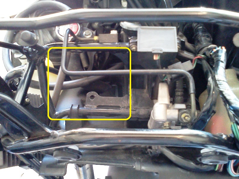

I searched around the bike for a suitable mounting point and eventually settled on the void directly behind the headlight. I have a non-ABS model, so I'm not sure if something ABS-related sits there on other bikes.
The Stebel Nautilus Compact (and likely the Wolo 419) fit very snugly in that area in a near-vertical position. The obvious drawback is that you have to pull the fairing to get it in there. I already had the front of my bike apart for a HID upgrade, so there wasn't any extra effort on my part.
I cut some strips of 1.5 x 0.25 inch rubber weather strip to pad the top and back of the horn body so it wouldn't vibrate or shift position. I also padded the frame bracket under the horn with the same material. The power leads rest next to the frame bracket, so I used insulated crimp connectors, heat shrink tubing, and a few wraps of electrical tape around the wires for abrasion resistance. The padding on the frame bracket was probably sufficient, but I don't want to get back in there again to solve a short that I could have prevented the first time. It was secured to the frame with a couple of heavy-duty zip ties.
Here are a couple of pics of the target area before and after the horn was test fitted. In these pics, the horn is diagonally mounted, but I eventually moved it inboard directly next to the tilt sensor. I needed more clearance for my fuse block closer to where the right pocket sits.

Bill: Thanks for the link, those are the photos I was referring to.
Arron: Thanks for the photos, the ABS gear is just were you placed the yellow box Smile
If I ever get brave enough take the front off I will have a go at fitting the Stebel.
