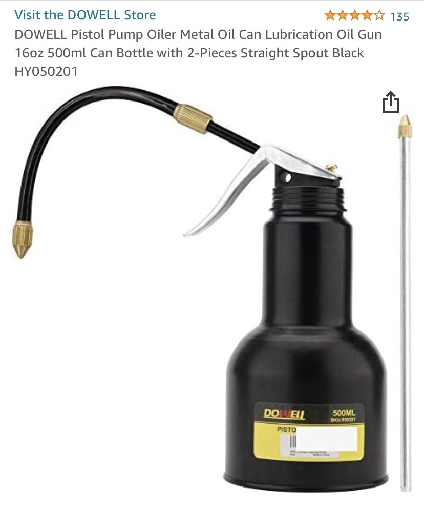

| Hi again folks! I am attempting to change the final drive oil in my Swing. I read a post from someone who uses a Mixmizer injector with an extension tube, so I bought one. The extension tube is too wide to go into the top hole from which I removed the bolt. I have seen other posts where some people are using squeeze bottles and they attach a tube. Others are using oil cans. Could I please request a few pictures of what is being used so that I can know what to get? Thank you very much! |

| Hi, I always use an oil can works well. |

| I used an oil can from Amazon. The metal tube without the copper nozzle worked well. The rubber tube without the nozzle probably would have worked also.  |

| I use an oil can as well (Harbor Freight I believe).
https://www.harborfreight.com/20-oz-flexible-spout-oil-can-1113.html |
