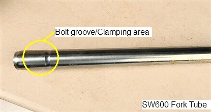

| The extension idea may work on a conventional motorcycle that has upper and lower fork tube clamps, the SW600 only has a single lower clamp setup, typically found in a lot of scooters, but is very robust/strong, relies a lot on the fork tubes for rigidity, any kind of threaded extension will weaken the fork assembly IMO, additionally oem tubes are grooved to accept lower clamp bolt and prevent fork tube from sliding, etc. I think best idea is to add a longer inner spacer and go to 15-20wt fork fluid. Aftermarket springs are not very available. One of the features of scooters in general is low center of gravity for more stability, etc. raising/changing this can affect handling !!  |

| In the absence of a proper fork brace, extending the fork tubes would only weaken the fork tubes and increase the risk of the tubes bending IMHO. Please see this discussion regarding forks bottoming out and zrx212’s excellent fork upgrade and Stefano Bonacasa’s similar fork upgrade using two additional Silverwing rebound springs and washers as posted in the SWCI SW-T facebook forum. https://www.silverwing600.com/t12150-forks-bottoming-outSorry about the poor quality photo. But the picture is self explanatory and Honda part #’s are shown.  |

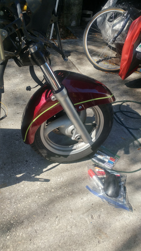

| the method cosmic jumper linked is easiest way to achieve additional front height and additional travel. it would allow front to sit higher. less sliding forward feel. the cost will be a stiffer ride. the stock fork setup allows a second method . the stock tube is over 1/2 inch proud of its mount. meaning it sticks out above the brace. adding a groove to tube the tube can be sunk into mount about 5/8 inch. this would in effect make fork tube extended in length by 5/8 in.  |
Number of posts : 1333 Location : Allentown PA. Points : 4144 Registration date : 2016-01-02
 | Subject: Re: fork tube extension for silver wing Sat Apr 30, 2022 7:53 pm | |
| - jerry-d wrote:
- the method cosmic jumper linked is easiest way to achieve additional front height and additional travel. it would allow front to sit higher. less sliding forward feel. the cost will be a stiffer ride. the stock fork setup allows a second method . the stock tube is over 1/2 inch proud of its mount. meaning it sticks out above the brace. adding a groove to tube the tube can be sunk into mount about 5/8 inch. this would in effect make fork tube extended in length by 5/8 in.
 I disagree that last bit of tube at top has threads in there for the cap and thinner metal. Modifying it would weaken it and could break it. SW has a unique fork clamp much different then most motorcycles only has one steering stem lower. |
