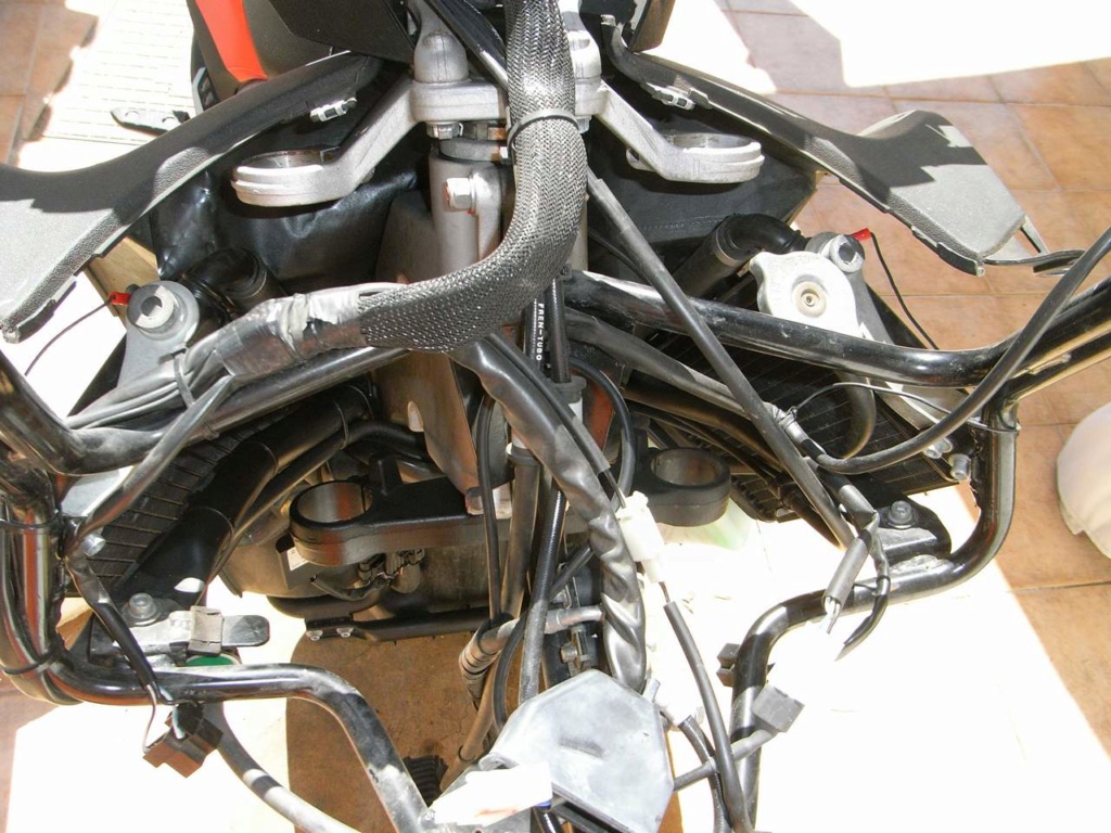

sometimes things get stuck, fused together, rusted together.
Often the only right way to do it is take it out completely and put it on the work bench.
I just wanted to change one fork oil seal and ended up to have to remove the complete front to reach the screws to the the whole tubes to take out.
One lower screw came out easily the other spun with the inner tube.
I finally had enough from this nonsense and put a drill with a bit in, to separate the inner tube via high speed and force and it worked with in seconds at 1000 rpm.
Fork tube stuck Compressed Fork10

What is that a photo of? While it does show a traditional triple tree, sans fork tubes, it certainly isn’t that of a FSC/FJS Silverwing. If it is from a SW-T it is significantly different than a FSC/FJS model. How does that photo help the OP?

No it is not, it is when I had just wanted to change one lousy fork seal on my Spidermax and had to dismantle all. It is an example of an easy job goes complicated as I mentioned in the conversion above.
I do cross references between bikes when I think It might give the OP an idea how things can get out of hand etc. and when I have photo material from my tech adventures.
