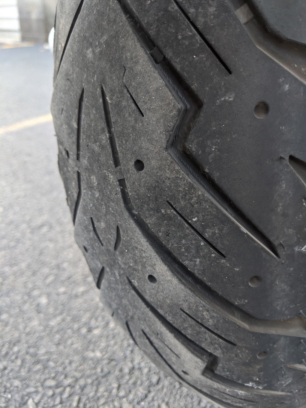

What size Angel did you put on front I can't seem to find a 120/80/14 listed only 120/70/14 in P speed rating?  93MPH.  SW has a 64S rated tire.   112MPH  I tried a rear once very uneven wear but I ride at a good pace most of the time.Tires just arrived bike bandit Img_2011
Center is at wear bars with lots of tread on sides and chopped.  Other than that grips great no slips or slides.
I did find a listing 120/80/14 but for a rear tire still P rated if that's the case it will have to mounted in reverse rotation for the front.
