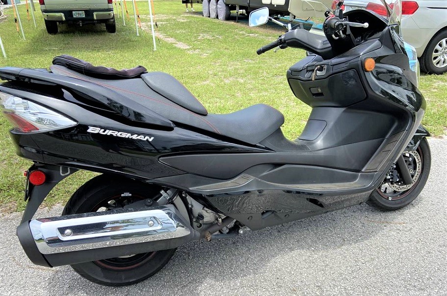

Stumbled onto this the other day while doing a lazy/time killing search on Craiglist, 2014 with 5k miles, literally owned by an older lady, A/C garage kept and covered, never been in the rain, just slightly dusty, purchased NOS in 2016, nearly showroom perfect, sat unused for 6 months due to health reasons, came with new battery, idle was a little rough and cvt not smooth, counter offered and took it home cheap($500 below asking) with motorcycle jack, covers, etc., etc.  2014 Burgman 400 1f60e  Literally they just wanted to make room for husbands new HD !!. They showed me receipts for 2 oil changes and new battery. 2014 Burgman 400 Burg110
2014 Burgman 400 Burg211
2014 Burgman 400 Burg311
 Took home drained fuel tank, filled with 93 non-ethanol and 4oz of sea-foam fuel treatment, cleaned and lube CVT components, oil change, replaced air filter and cvt filter foam, etc., etc., otherwise bike is like new. This engine has 12.5:1 compression, IMO 91 or better should be used, the newer(2017+) version has 10.6:1 to comply with emissions and less power.
 Started and let idle for 20 minutes, idle became stable after 5 min., fan cycled, etc. test rode, bike is very smooth and handles well, very slight vibration from the single at idle, everything works perfectly. Hit 90mph easily, Very freaking happy  bounce cheers
 just a little concerned about tires age, but they are not even sun stained  Shocked

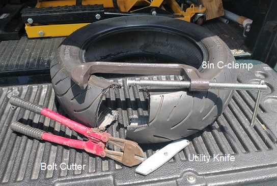

Lots of labor. I did many a dirt bike tire but those are much easier and side walls not so stiff but tube type don't pinch it. My buddie has a car type machine that's the only way I would even try it. How did you break the beads? Cut off tires with what?
Damm dealers around here want $50 bucks to mount a tire 10 minute job with a machine. BS.

 " How did you break the beads? Cut off tires with what? "
 1st let me say this, the process for DIY tires is labor intensive, requires some mechanical knowledge(as you can do a lot of damage to man or machine !!) and some of my methods are dangerous, TAYOR, use protective gear !!
 Anyway, I break the bead with big "C" clamp(s), you clamp/collapse sidewall until bead separates, you can clamp tire directly and/or use a flat pieces of wood, either way provide
a way to prevent rim damage/scratches, rags, plastic sheets/tubing, etc.
 Once the bead is broken, "CAREFULLY" cut a section of tire with a "Real Sharp" box cutter(Stanley 99), a dull blade is very bad, score and cut slowly, cut as close to bead wire as possible, then cut bead  wire(s) with wire cutter, again protect wheel, etc.  Done !!
 I'll attach pics ...
