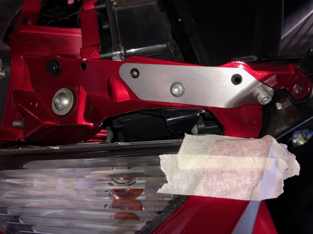

Givi windshield 04 swing 400dc810
Givi windshield 04 swing 41447f10
Thanks BJS for your original post.  Motivated me to pull down the new GIVI.  Started late last night and finished this morning.  Was concerned of warping due to garage storage (14 years) here in SWFL but it fit flawlessly.  I added the extra harness.  Was fairly easy...used a slow speed drill (or battery going dead) and made the holes.  One of the push pins broke but 2 way taped it back on and one Teflon washer is lost in the abyss. Found something similar to replace but what a difference while riding now. My top hairline is not being blown inward.  Ya Gotta keep the hair that’s left right.  Luckily I’m not any taller than 6.1 or shield’s top would be in view.  Now need a can of Plexus to keep clean.  These Givi’s scratch too easy. Have a safe one.
PS photos show my install.  Was it done right?  Not sure if support bracket went on top of GIVI or bottom. Chose bottom   OOPS!

Glad you got it done. Yea,makes a big difference. I'm not sure if the brackets go on bottom or top of shield, but I'd guess the bottom. Great pics. Looks like you did a really neat job.

Thank you in advance for your reply. So I did it correct according to my photos attached above? I hope so cause I cannot see the brace reaching on top of GIVI. Thx again for your time and talent.

I fitted the re-enforcing bracket simply because the instructions said so. Whether it adds any strength to the operation of the screen I don't know. I feel happier knowing it's there. Just my two-bobs worth.
