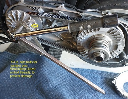

Malossi only makes one spring for the SW600, I got mine here https://scooterpartsco.com/index.php?main_page=index&cPath=100_3511&sort=20a&page=2 , great prices and fair/cheap shipping cost, they have 3 pages worth of parts for SW600, if you can place an item in shopping cart, it is in stock.
I've found the SW600 cvt, to be one of the easiest to work on, given you have some mechanical abilities and/or watched plenty YouTube videos, etc. scratch
I'll attach a few pics showing some of "my special tools", a good/large 90 deg, expanding snap-ring pliers, really helps when replacing torque/contra spring. I've have used my drill press to compress springs, but have migrated to the 1/2 threaded rod method, using suitable sockets and pieces of wood, etc., is safer IMO. 2nd pic show my Burgman 400 but is similar idea.

Hi again john. Ok I understand your mind set now.
What you need to do is work out a game plan for the work you will do. plan for weekend work, less chance of being disturbed.
The only time you won't be able to move your Swing is when you take the front wheel off to replace the fork springs, working on the service or drive train you can roll it back or fourth should you need to.
The Malossi white spring will require some form of compressor, I used some threaded bar, a few washers and nuts, check my post pictures on "Malossi White post". Or search "tools" on our forum search for various ways to do it. There are also some good vids on YouTube to.
You will need a universal pulley holder to hold the varaitor while you crack the front nut to remove the drive belt, and again when you torque it back up after completion.
So read up the order of disassembly a few times, check you have the tools needed, don't multi task, either do the service first, or the drive chain, a couple of small containers to keep screws/bolts separate for each layer you strip down and a sharp intake of breath and go for it.
There's always someone on line here so shout out if you hit a problem.
Hope this helps

Nice idea of using the threaded rod to compress everything ,so I would need to put equal shimming on the caplike piece that compresses the spring then remove the retaining ring then loosen the threaded rod till the the spring moves freely , then install new spring caplike thing plus shimming and retighten threaded rod until I can install the retaining ring ,
I seen a variator holder in a video made out of flat stock alum about 2 1/2” wide 18” long with two 14/20’s with a hole saw hole slightly larger than the socket head needed for the variator ,I believe that’s a 22mm,,
Does that sound about correct ?
Thank you for posting the pics I feel bettter about doing this myself now..
Ride Safely
John
Hope this helps
Be safe, be seen and heard.
Ps. thanks zrx212 for the above post
Yes Sir that’s exactly what I was thinking of doing ,and after a little more research on the forum the spacers in the forks aren’t needed with the new springs and that the spacers are up on top which will be saved with the springs , may I ask you mentioned about washers being returned from the dealer with the spacers and springs ,would the new springs be coming with new washers ? I can gather the stuff needed for the variator holder while waiting for the parts to come in…
