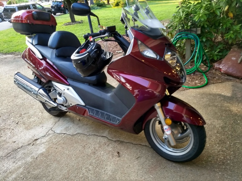

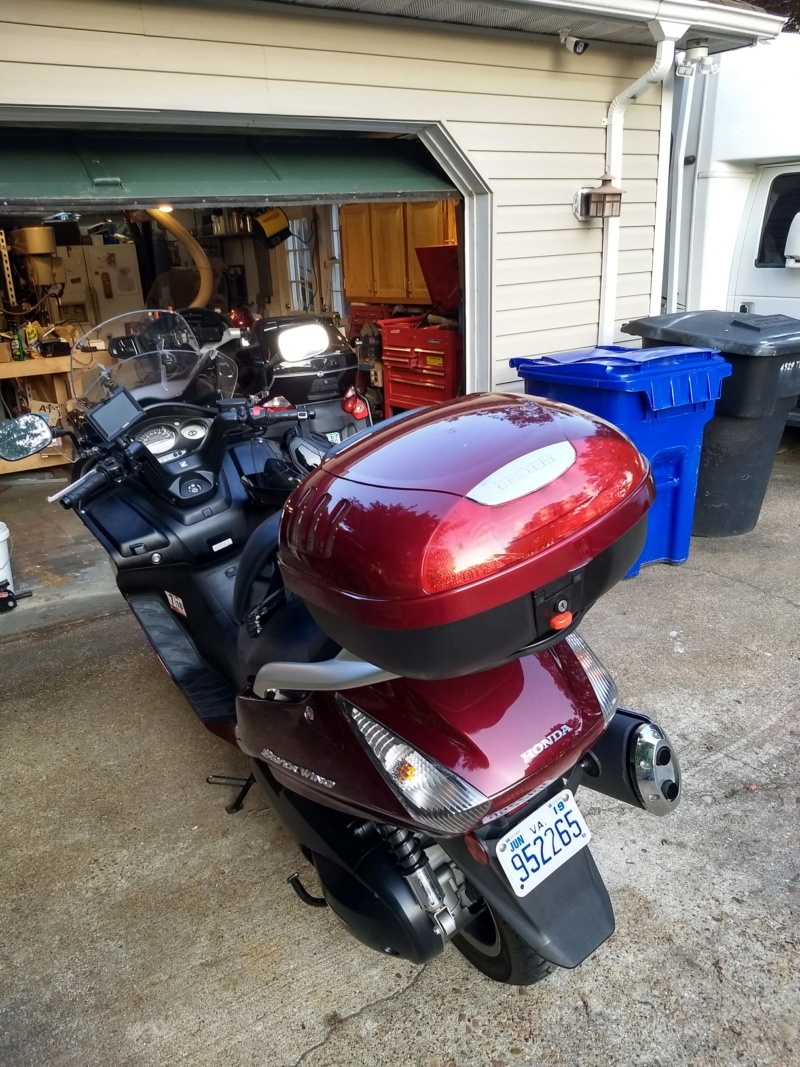

I have a Bestem box.  Like it for the price, much cheaper than Givi.  Had to make some custom mounting bars out of Aluminum to adapt the curve on the rear rack mount.   And it came in a color that looks like it was painted to match the bike.
Had a PCX 150 with the factory Honda box.  Can't say that box was head and shoulders above the bestem in terms of quality or sturdiness, but it had to have cost about 5x as much.

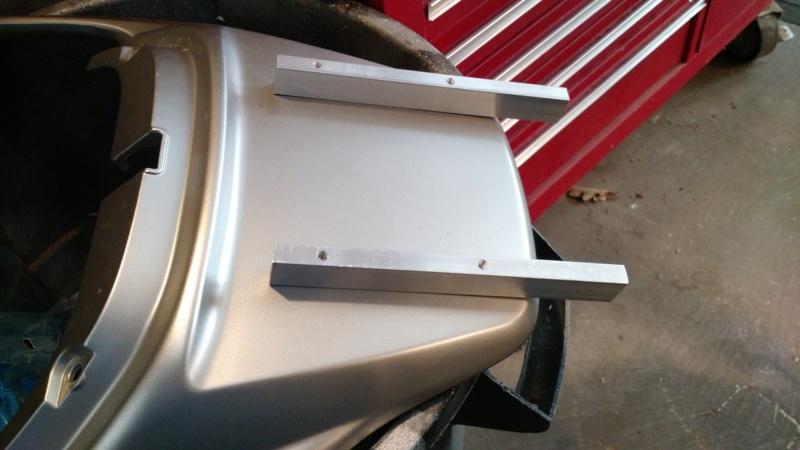

I didn't take as many pix as I usually do, but here's what I got. I used stainless hardware not the stuff supplied with the box and tapped the aluminum bar so I didn't have to worry about using nuts. Used an anti-seize on the threads.
Drilled underside of mount through
Aftermarket trunks for SWINGS Img_2023
Test positioned bars
Aftermarket trunks for SWINGS Img_2022
Shows some of the hand shaping of the underside to match the curve of the mount
