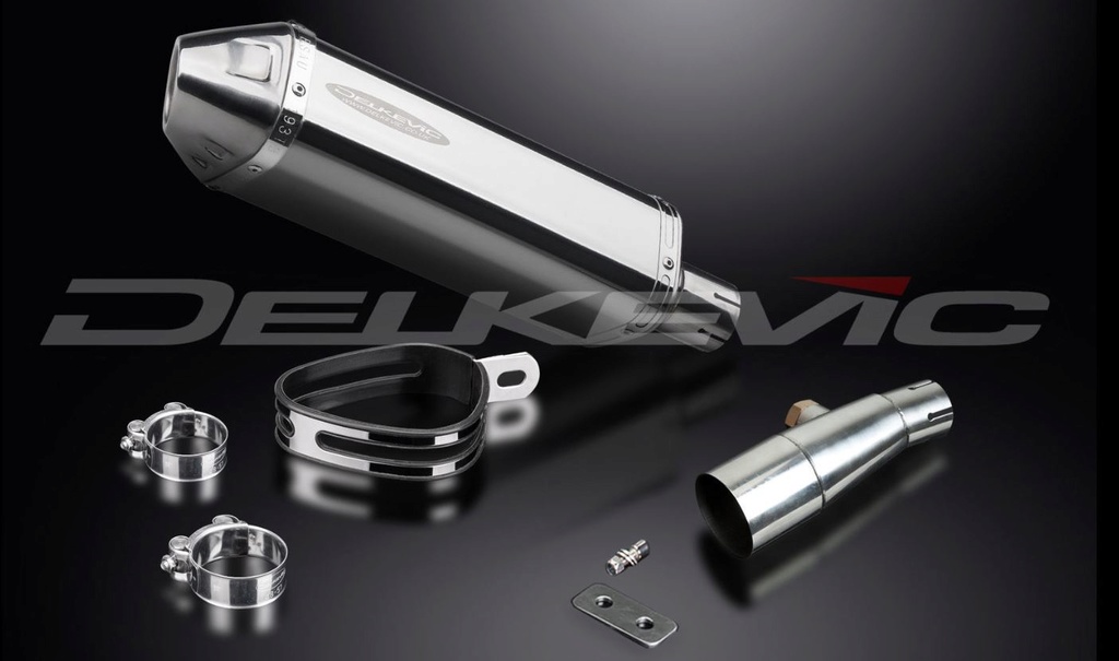

This thread will eventually contain all the info of the various stages I've gone through while 'tweaking' my Swing. I will edit this original post to keep all updated info in one place.
So far I have a dyno baseline for a stock 5,000 mile engine with 22gram Dr Pulleys.
I have since fitted:
Step 1) A Delkevic 320mm stainless exhaust. It is significantly light and narrower than the stock item. I also removed the snorkel from the airbox.
Step 2) Fitted a new sensor to replace the IAT probe to trick the engine in to thinking it was 20 degrees C colder than actual. This should richen things up during acceleration by around 6%.
Step 3) Replaced entire airbox with large (6" long, 3.5" dia) K&N pod filter mounted to the plenum chamber. Details to follow. Kept the -20deg C probe at this point.
Step 4) Fitted a -25C probe and removed the luggage/grab rail. That shaves off a fair few more pounds, and only take circa 60s to replace if I plan to take the wife out.

Yeah, it feels better, but even I was surprised how much faster it actually was. There's a big dip around 50mph when the Dr Pulleys transition from their acceleration profile to their cruising profile. This causes the revs to dip down below 5,000rpm. Peak power is probably north of 6,000 still on this motor - stock was 6,250rpm. Once the engine's finished I'll then sort the transmission to match. Will probably want a stiffer contra-spring to more the target rpm to just over 6,250rpm. The will hopefully shift that dip until after 60mph, i.e. after you've finished acceleration most of the way.
The K&N filter fits neatly under the cover, loads of free space. The problem is more one of getting the airbox off in the first place. Honda fitted the clamp with the screw head facing into the bike, so you have to remove the entire back of the bike to get to it (grab rails, both side panels, rear panels, battery & box, luggage compartment!). Once remove, just face the head outwards, and you can get to it by poking a screwdriver through the gap between the luggage compartment and the engine cover. Not the best decision by Honda me-thinks.
Filter is an RB-0720.

I would like to put on a slip on to lose a few lbs. but I do not want to annoy anyone with an objectionably loud scooter. I've been looking at a few Delkevic models online. How would you rate the noise?
gavinfdavies
Number of posts : 136
Location : Newport, South Wales, UK
Points : 2157
Registration date : 2017-10-20
Exhaust, pod filter, IAT probe mod: performance results Empty
PostSubject: Re: Exhaust, pod filter, IAT probe mod: performance results   Exhaust, pod filter, IAT probe mod: performance results I_icon_minitimeSat Oct 06, 2018 3:09 pm
I can only comment on the one I have (pictured), and it's not too obnoxious. No worse than a typical sports bike, and certainly not as bad as anything with a straight through pipe. Passed a road inspection (MOT) here no problems.
I mean, I don't worry about warming up the scooter on my driveway (a very closely packed housing area. Think 6m wide plots!) at 6am. I just have to do it on the drive. I tried doing it in the garage with the pipe pointing out the door, and the wife ran downstairs to tell me off because it was acting like a fog horn!
