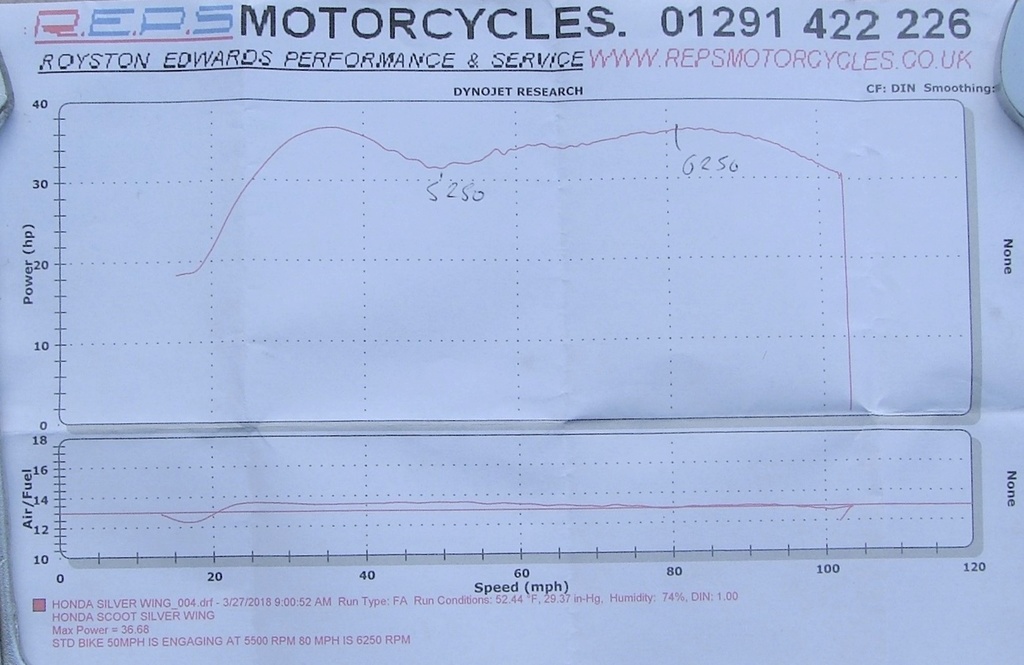

The baseline dyno run was completed last week. Stock engine, the only change being the 22 gram Dr Pulley sliders and sliding pieces. The engine mileage was 4,500 miles, and the fuel was 'normal' unleaded (95 RON, as opposed to premium 97/98/99 RON etc).
Fuelling is a tad rich at high rpm, which is good. The bump in power should be ignored, as that is a side effect of the transmission fully engaging and having a bit of a flywheel effect. The highlighted RPMs are where the transmission finished fully engaging, and then peak power.

36 HP stock to rear wheel but its fun to ride. How much more HP do you think is possible from mods?
You are on the right track matching engine power to drive line for better acceleration. 0-75 MPH is where its at for this type of scooter.

The exhaust alone without a new fuel map is supposed to give an extra 3hp, this seems right as various exhaust manufacturers claim this - I've even seen a few dyno graphs from them.
I'm hoping that with a new filter system and some fuelling mods to get maybe another 5-6rwhp. Maybe a little more if I got some header pipes modified to match the ports in the cylinder heads. But after that it gets more tricky, and we're looking at throttle bodies, cams, porting etc, so I'll stop there.
Maybe if I ever get a properly stripped bike just for sprinting I try some more extreme stuff. Something like a 36mm flat slide conversion and some hotter cams.
Basically, I think of this as a long-stroke 500cc twin, not a 600cc 'normal' motor. So 45rwhp seems about right, like a CB500, or Ninja 500 from the 1990s.
