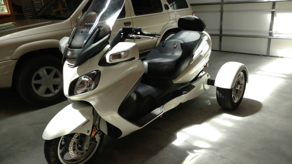

| While I was doing 65% I traded for gasp! Burgman Motortrike which I still own. The wife and I cruise at 70mph no problems and there is reserve. Can't see how a Silverwing wouldn't work nicely as it is only about 8 horse less. I would bet Motortrike uses an appropriate sprocket. I have heard of short chain life but I suspect good rear end alignment and chain adjustment came into play. As for the ride it wasn't good and then I adjusted the rear tires to about 21#. Not much weight for car tires. It rides great! Handling is opposite of a 2 track. Lean out in turns and apply gas (within traction/gravity limits) and it pulls you right through. Riding like this I could keep up with 2 wheelers riding briskly (1 up). There is one more wheel to steer around obstacles and that's the down side. A Tow Pac ads another wheel. I still own my Sling. |

| Easyrider Glad you two still like to get out in the wind. When the wife comes along it's on the trike.  |
