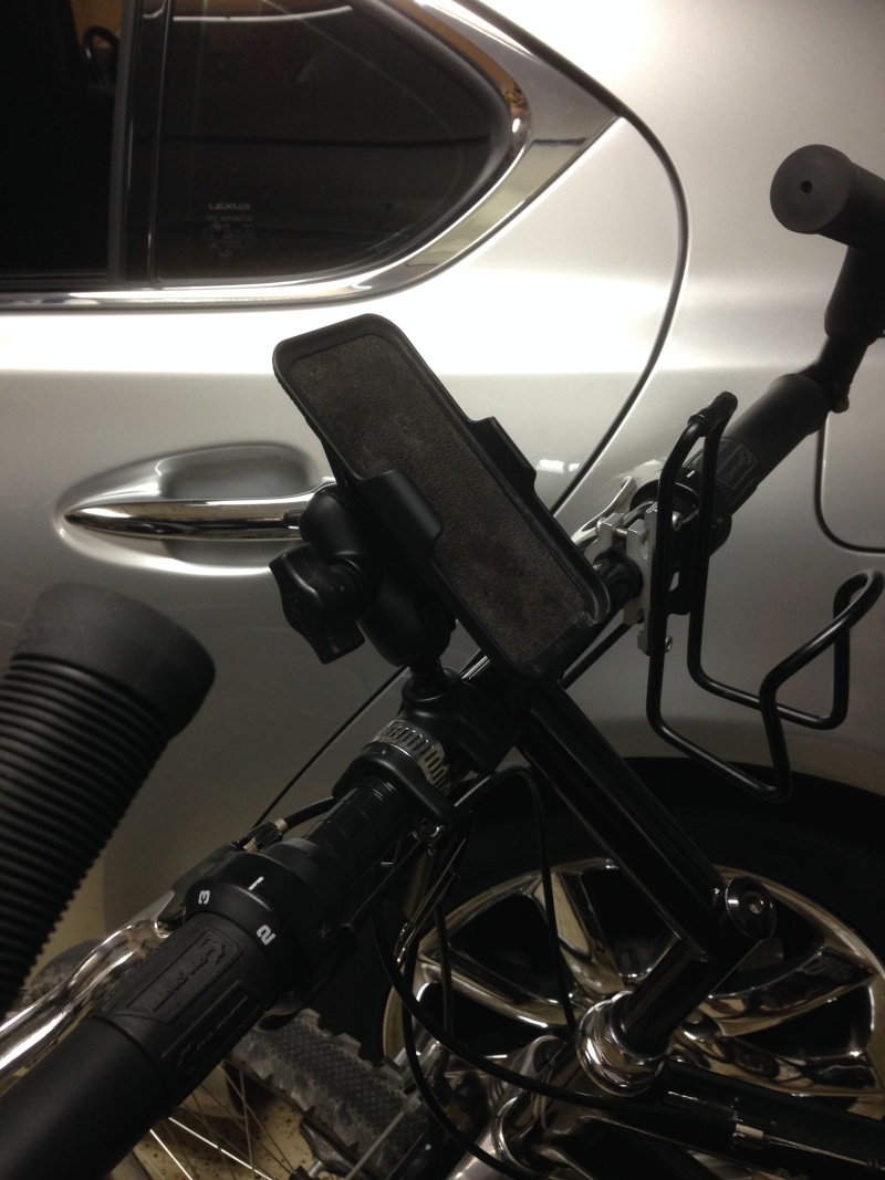

We both use the Aduro case/holster (around 15 bucks depending on your phone) modified to be a Ram Mount. I attached a ram diamond ball (RAM-B-238U) to the belt clip so we can still use the rotate feature while the phone is in the holster. This setup is almost three years old and shows no sign of wear or fatigue on the holster.
I also use the setup on my bicycle that gets 15 to 20 mile rides in the desert at least three times a week. The phone has never come out of the holster during my occasional crash on the bicycle.
****I noticed the picture of the mount on the Silverwing is upside down. I trimmed the bottom as to access the audio/charge port while on the wing****
https://www.youtube.com/watch?v=2fLRGf48xU4
