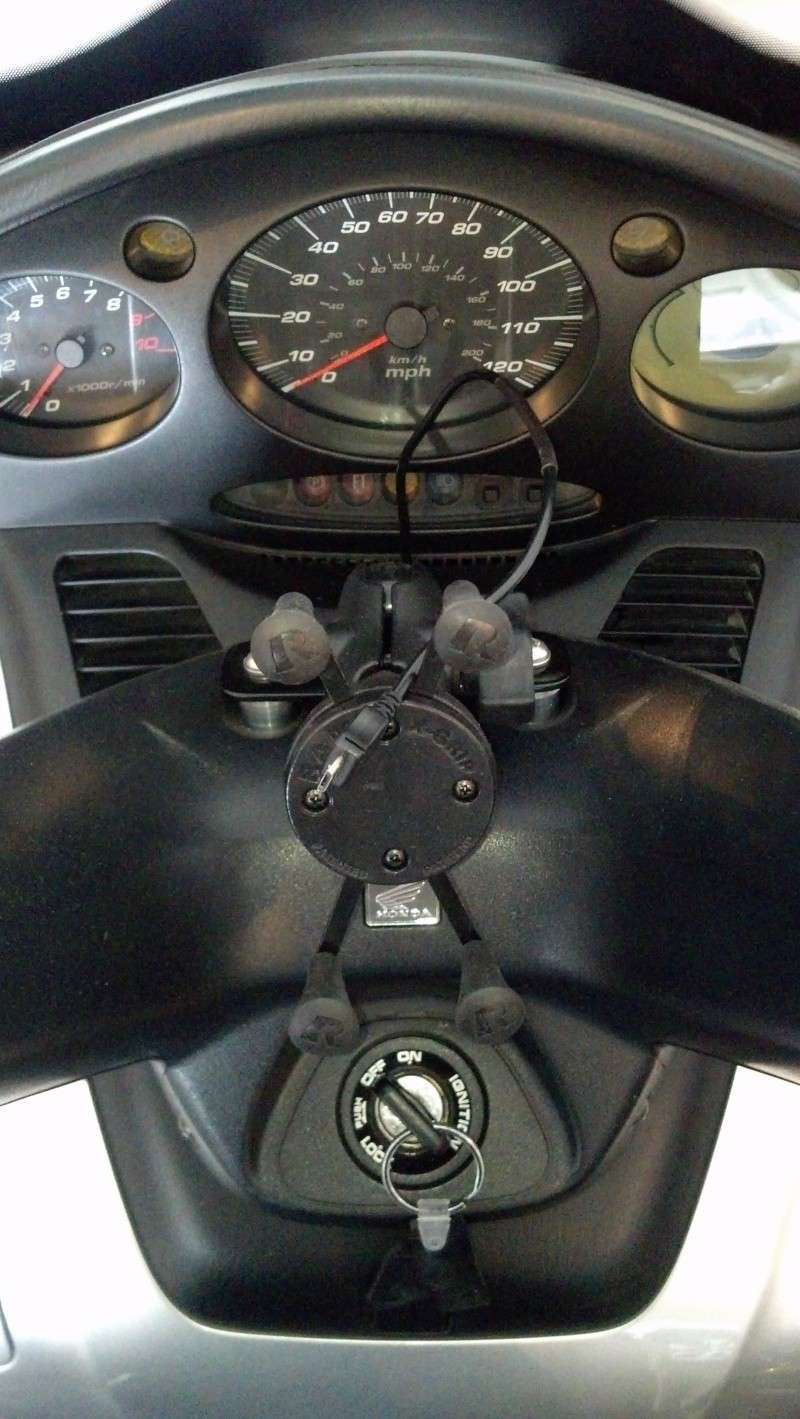

Here is my arrangement. DennisB supplied the center bracket and I bought the ball, short extension and a Ram X-Grip. I also hardwired a Micro/Macro USB inside the cowl and ran the wire up through the dash just under the status lights.
gps or phone mount 2013-010
