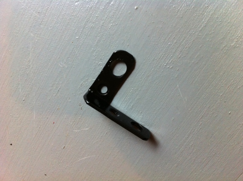

i had to make a bracket (2) for the light mount. this is just a flat L bracket from the hardware store ($.79) that i bent and drilled to fit the required holes for the light and existing mounting bolt. I painted it black.

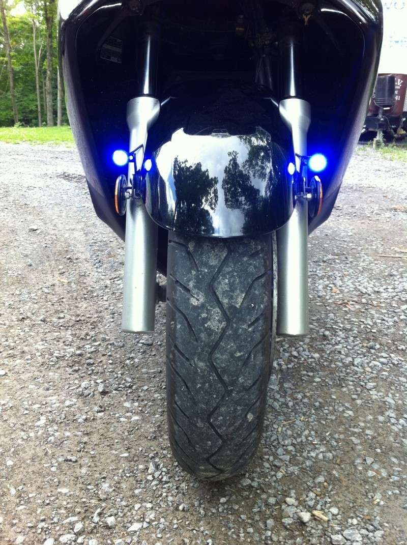

One of the lights installed. I ran the wire from the right light thru a plastic stick on tab that i mounted on top and center of the fender to prevent that wire from flopping in the wind (sorry no pic of that). I then zip tied the wires along the brake lines and up into the fairing where i tapped into a keyed power wire.
extra running lights Image13
The finished project. I havent ridden with these at night yet but they do cast a pretty good glow on the garage floor. With the bike outside in daylight and standing a couple hundred feet away the lights are an eye catcher. After i installed them yesterday i was thinking it would be nice to have the option to turn them on and off so i ordered a lighted switch from ebay. It will take 2-3 weeks to get the switch. It was a fun project and only cost around $15 total including the ordered switch.

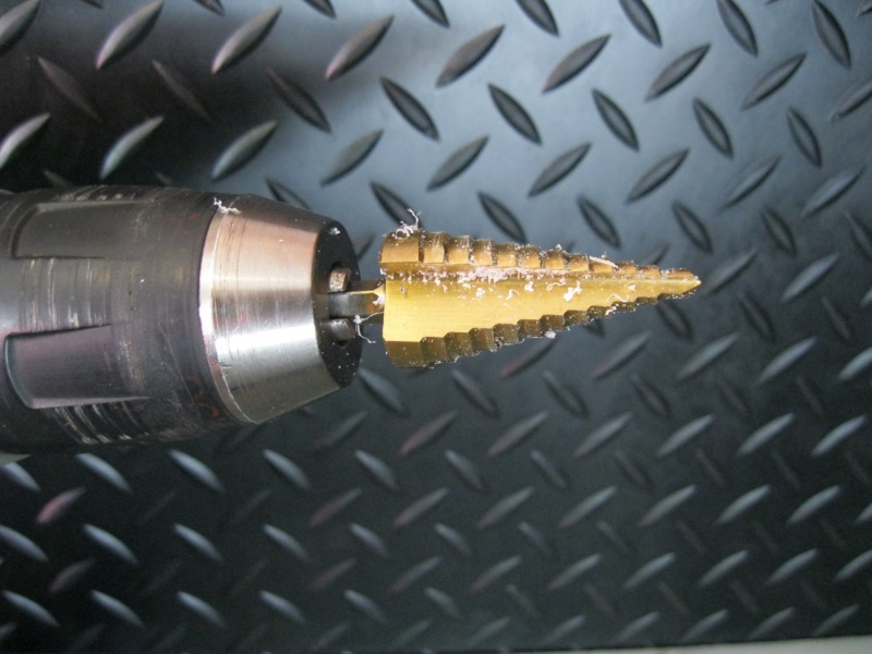

Finally got around to installing the switch for my lights. I had a hard time finding the required 20mm or 13/16" drill bit. I found an affordable step bit for $20 that worked perfectly. By easily removing the right glovebox i found where the switch could be mounted, making sure there were no obstructions behind etc. I stressed and fretted and paced the garage floor before getting the courage to plunge the bit into the shiny black finish. I installed the switch to the side so i can install more switches later as the need arises.
extra running lights Img_1521
This 12 step drill bit worked perfect for the task.

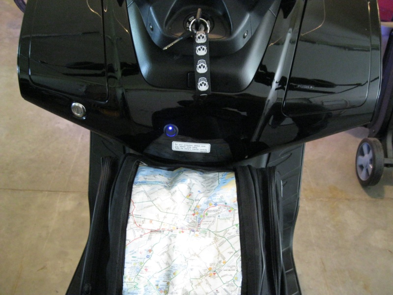

I had to run an extra wire for a ground to the switch. The switch has a blue led light that illuminates when the lights are on.
extra running lights Img_1523
The finished project. The lights are on cheers
