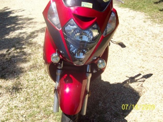

W0THK
Number of posts : 4
Location : Minneapolis, MN
Points : 5196
Spot Light Relocation and Bracket Empty
PostSubject: Re: Spot Light Relocation and Bracket   Spot Light Relocation and Bracket I_icon_minitimeWed Sep 23, 2009 3:05 pm
I finally got around to installing my light bracket. It fits like a glove! Excellent work, Dennis!
One thing to keep in mind is that the light bracket will NOT be at chassis ground. This may or may not be an issue, depending on the type of lights you use. If you use two-wire lights, it won't matter. However, it you use a single-wire light that wants to ground through the bracket it's attached to, you'll need to run a ground wire. I'm using the Kuyakyn Silver Bullets and ran into that issue. It's not a really big deal - just something you might need to be aware of.
Keep up the good work, Dennis!!

Do you make more than one version of the spot light bracket?
In the photo of the red SWing, it appears that a single cross bar bracket locates the lights 'outside' the body line.
While an earlier photo seems to show that there are two brackets attached to the cross bar which locate the lights forward & up in front of the air inlets adjacient to the headlight high beam.
As good as most of the photos are, there seem to be just enough glare & reflections to make it difficult to determine exactly how/where the lights are positioned.
Points : 8680
PostSubject: Re: Spot Light Relocation and Bracket   Spot Light Relocation and Bracket I_icon_minitimeThu Oct 01, 2009 10:30 pm
I just make one. It's a good fit for most lights. What is making the light bar look different is the angle of the photos in relation to the scooter.

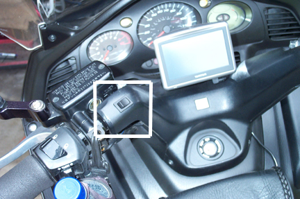

Yes I do provide wiring diagrams of both the lights and Relay installation.
I have a un-lighted small rocker switch installed on my left handelbar cover that controls my spot lights on and off. I also installed a relay under my scooters left side cover that I purchased off ebay to turn my lights off when I turn off my scooter key.
Spot Light Relocation and Bracket Switch10
