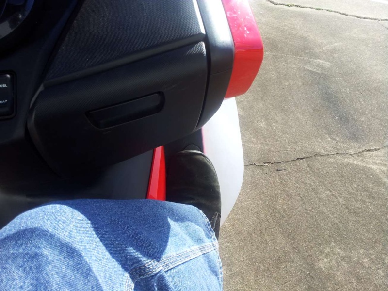

Got my hand and leg wind deflectors and installed them tonight. I can't wait to see how they work in the wind. I don't think they should hurt aerodynamics, at least I'm hoping they won't. The hand deflectors look especially nice on the bike, almost like a stock panel. The leg ones I got seemed to have the same ribbing on the outer side as on the inner side and so don't look as clean as earlier incarnations, but heck all I care about is if they do the intended job. I did need to trim off a tiny amount where the edge comes up to some ribbing that makes the edge thicker to tuck in between the two panels, but that was easy. The fit and finish of the products are very good. Now lets see when I get my cut down Givi 214DT in combination with it. My hands should be real warm when the cold weather arrives. Cool

I installed my wind leg deflectors yesterday and tried them out on a group ride today - temp this morning was about 30 degrees [F] and the deflectors made a big difference - certainly an improvement and my legs were much warmer as a result of the additional protection - recommend to others.
My installation was not difficult but not a smooth as expected for the following reason - the holes in the deflectors did not match up to the nubs in the mat for some - I had to use an exacto knife to open up 2 of the three holes so that the mat would properly go back into position - this was on my 2002 SW. That said, the rest was pretty simple - I did use the screws included with the deflectors to attach them under the mat. The deflectors didn't budge at 65 mph on the freeway today.
Finally, I put three pics of the deflectors mounted on my SW in my album.

These might be extreme, but I went to the dollar store and bought 4 cutting mats for  $2.00.
Each pack was $1.00 for 2 mats. I cut the mat so it would fit under the floor mat and used the floor screws to hold it.
You can search the net and get commercial cutting mats that cost more and larger should you wish to have heaver duty,
colored plastic, or even larger size.
I creased the top edge just a little of 1/4 inch and used industrial velcro to hold the top in place.
This is what is looks like on my Forza. I made a set for my Burgman 650 and painted them black to match the bike.
I thought there is to much red already on this one. I did not make a set for my Silverwing, but it should be just as easy.
I cut them long on the side closest to me making them bow out. You can increase/decrease according to taste even
if you make them short. If you drop the bike you aren't going to break them. You can make varying sizes for different seasons
and still come out cheap. If you paint them, the paint will be your most expensive cost.
You can cut it and shape it as small as the others or as large as these. I use them in the winter because of my uncle Arthur.

I must say these look quite good and for minimal cost. Great idea. I'm looking for the cutting mats on my next shopping trip. Where would you find industrial strength velcro?

Industrial velcro was at the local hardware store(Lowes). I always keep some in my tool box. Use it to hold my gargage door opener to the top of the glove box too. Makes it easy to move between rides.
