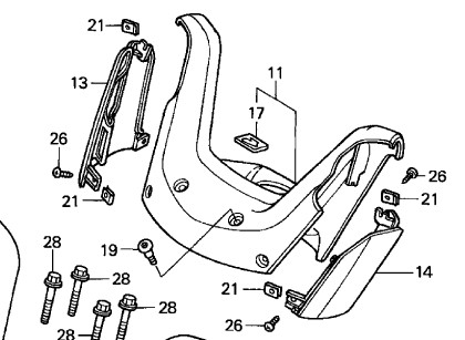

FWIW, I went through this whole problem with the handlebar covers as mine had been abused in the past. In the end I ran out of ideas and replaced all three parts 'from new' over a short period of time.
If I've got it right, the screws which winged warrior is referring to are number 26 on this picture?
Repair handlebar fairings Handle10
Part No. 93903-34380, they are 4 x 12.
If so, they are available from the UK.

[quote from loose marbles
correct, I was givin the impression Honda Canada does not have them anymore - and the ones I had were loose as it was.
