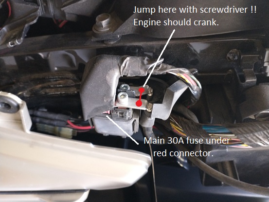

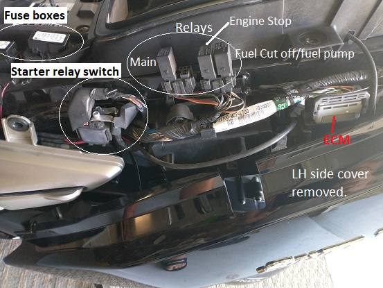

| Went out in garage and got a few pics (BTW very hot out there  ), if you jump the big nut terminals on the starter relay switch, your applying direct voltage/current to starter motor, starter should operate/engine should crank (not start) as long as you hold a screwdriver across the terminals, key/switch does not have to be on, If not, battery is bad, starter is bad, engine internal starter clutch is faulty or engine itself is somehow locked (worst case scenario  ) , BTW reply with new message on this thread, updating old post won't trigger a reply message for others following the thread.   |
fredril Scooter Rider
Number of posts : 8 Age : 79 Location : Estero, FL Points : 48 Registration date : 2022-07-07
 | Subject: Re: battery voltage : wont start Tue Jul 12, 2022 10:15 pm | |
| Thanks for the photos. Just went out and jumped the starter relay switch. Got a little spark but nothing else. Turned the key on and the main relay buzzes but when I then jumped the starter relay, the buzzing went off. No idea what that means. Checked the fuse boxes under the seat again and they're all good. I'll check the main fuse again tomorrow but when I checked it the other day it was good. I hope this is what you meant by starting a new message. I kind of know where the starter motor is but don't see any way I can get to it without taking a lot of stuff apart. Therefore, I can't connect a wire to it to see it it will turn the motor over. Do you think there's a way to poke a wire in there to at least test it? Thanks again for all your help. I really appreciate it. The bike always ran so well and when the battery ran down, it would still turn over but not strongly enough to start, but the lights still came on. Parked it and the next time I went to start it, it seemed like something blew and then nothing at all has worked since. Crazy:)! |
