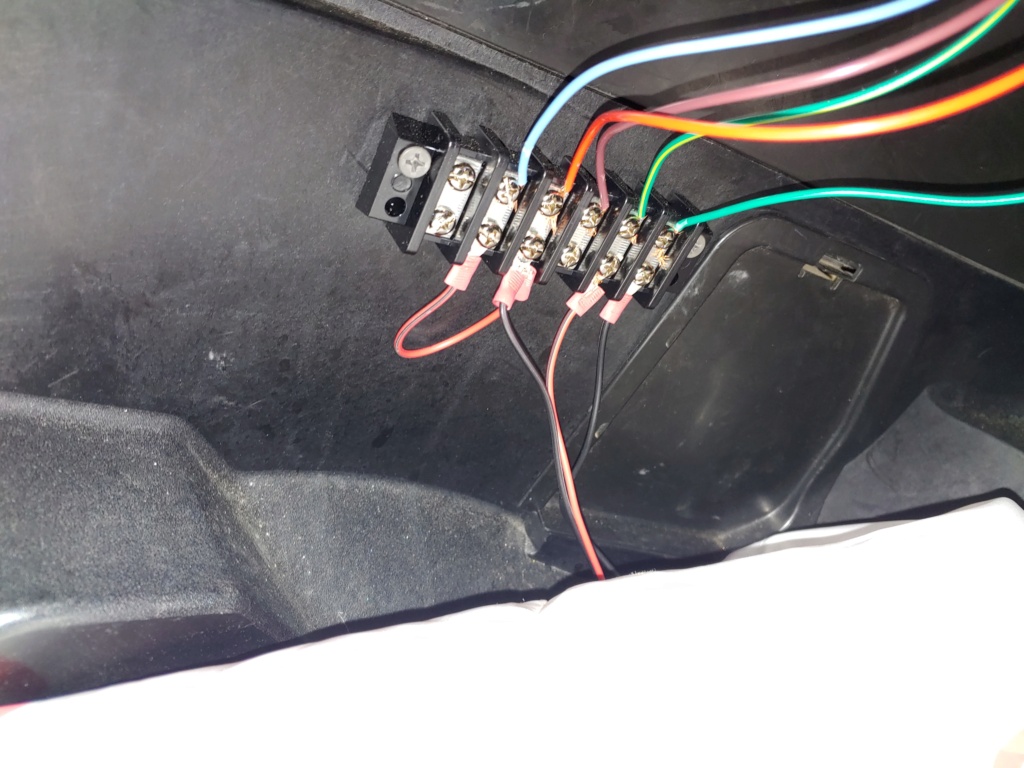

I drilled a small hole into the trunk, under the spoiler so you can't see it. Then I actually mounted a wire block I got at the hardware store, so I could easily remove the box (without rewiring everything) and/or change the configuration.

This is the wiring block in the trunk. The tail light wires were accessed through the little removable panel on the left back side of the trunk. The wires on top are from the top box.

There are a lot of ways to connect up the lights. I wanted a steady spoiler light for the brakes and steady running lights vs. blinkers for the two side lights.

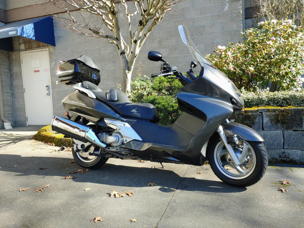

Looks OK. Amazon LED Top Case 20220331

I know... it's a bit hideous. Laughing You can say it. Smile
But I do feel safer with the higher lights. I am on the lookout for a better quality/looking top case more fitting the color and lines of the SWing. thumbs up

Maybe looks top heavy because of the low angle shot of the camera, but on normal viewing, I think it looks good. Give yourself more credit. Nice job, and maybe as serviceable as the "quality" boxes. It's a nice big box that holds lots of stuff. That's what I would want. Yes, and higher lights advantage: Safety first!

as long as it's well secured, these beasts of scooters are not really sensitive for being top heavy
(and the number of times i hauled my Audio amplifier for service, that's 45KG of metal in that top box.
Aesthetically -not sure this would be my choice, but from every other aspect - looks like a kick ass work.

It may have looked odd with the stock screen. As it is, I think it enhances the SW lines. Cool thumbs up
