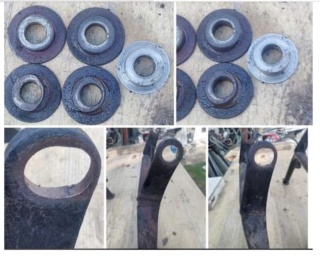

Could be that the center stand bushings and stand pivot holes are worn. Seems as if that would be most probable on higher mileage Silverwings. Below are two photos posted by Dave Kitchenman Batter on the FB’s Silverwing 600 forum*:
Centre Stand 'Clang' When 'Rolling Off' 3c1cc910
Centre Stand 'Clang' When 'Rolling Off' 91cd0c10
*That post and comments are worthwhile checking out if you’re able to find it.
