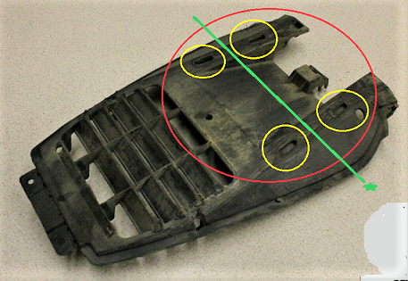

You'll see 4 dimples about 3/4 back on lower plastic aft of louvers, center jack there with piece of wood, foam, etc. I use a scissor jack, no real structure above front louvers area.LIFT POINT Sw10610

PostSubject: Re: LIFT POINT   LIFT POINT I_icon_minitimeSat Jun 05, 2021 9:53 pm
I understand,... Thank You again!

PostSubject: Re: LIFT POINT   LIFT POINT I_icon_minitimeMon Jun 07, 2021 9:40 pm
I used a scissor jack under the tubular frame cross member at the rear of the plastic piece in the image above. It does seem like a long way back but the Swing carries most of its weight to the rear so it provides a strong and stable point.
