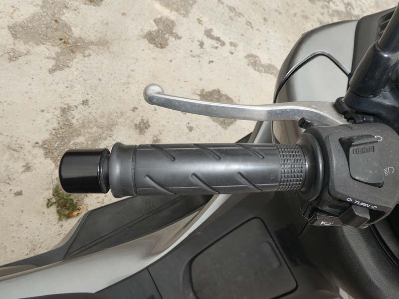

PostSubject: Re: Front Wobble on Decel   Front Wobble on Decel I_icon_minitimeSun Oct 27, 2019 10:45 am
My previous owner installed heavier weights what did not look too nice, but he kept the old ones.
My new owner did not like what he saw, took a dremel, cut off the inside part of the new ones , combined the old ones with the new ones and put a black O-ring in between to hide the little gap.
Result, Bigger, Longer and Cut (South Park movie reference)
picture 2 is before the repainting.
Front Wobble on Decel Grip110
Front Wobble on Decel Grip210
