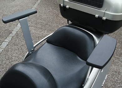

Here's a photo and a link to DennisB's arm rest post. As Meldrew notes, DennisB closed shop many years ago and has been MIA for quite a long while as well.
https://www.silverwing600.com/t812-arm-rests-kits-available-now?highlight=Arm+rests
Armrests for pillion on the Silverwing Image19

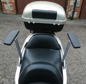

I finally finished the armrests for my SW. I needed these to be rather sturdy to help support my Partner, Allie, although she insists that she doesn’t need them and has actually ridden without them but I feel better knowing she has extra support if she needs it. Because of Allie’s disability I will attach the armrests ‘after’ she is seated and remove them ‘before’ she dismounts.
(I had to do this on a tight budget and had them formed from a piece of mild steel which I had lying around).

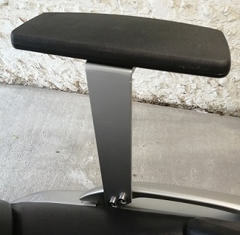

These are the armrests with some office chair armpads attached. I went for an inverted keyhole attachment so that they can be removed easily:
Armrests for pillion on the Silverwing Arm_re10
This was by means of using Shoulder Bolts:
Armrests for pillion on the Silverwing Should10

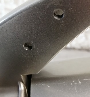

I then drilled and tapped the holes to attach the armrests to the sissy bar:
Armrests for pillion on the Silverwing Holes_10
The keyholes allow for easy attachment and removal:
Armrests for pillion on the Silverwing Should11
Armrests for pillion on the Silverwing Arm_re12
Securely attached:
Armrests for pillion on the Silverwing Arm_re13
Some pics of the finished product:
Armrests for pillion on the Silverwing Arm_re14
Armrests for pillion on the Silverwing Arm_re16
Armrests for pillion on the Silverwing Arm_re15
Armrests for pillion on the Silverwing Sw_ful10
I made these using only hand tools. I’m sure that anybody with machine tools and more metalwork experience could easily do something similar and perhaps use aluminium to save weight. They are also interchangeable so that you could have the arm pads facing inwards if required.
