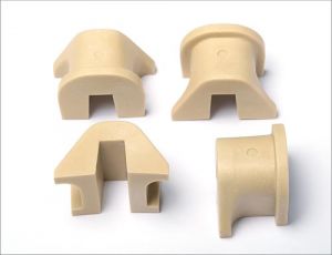

The Dr. Pulley Rollers arrived last night (and came with SP2820-W Sliders as well), I had already bought those from Dirk the other week, oh well looks like I have a spare set now. If weather is ok today, I will go for the Belt, Rollers, Sliders & Air filter change, then a test ride Wink

You can install sliders or rollers but not both. By design sliders have the ability to lower the RPM at the 60+ MPH.

I understood that you can install both, why would they send both out in the package ?

Confusions of terms. Those are Slide Pieces (SP), which fit on the ramp plate. Sliding weights / Sliding Roller weights (SR), commonly referred to as "Sliders", are distinguished from Rolling Roller weights (RR). Both of which fit in the variator.

Well, all sorted today. Changed Belt, Sliders, Slide Pieces, Air Filter, other Filter, cleaned all the gunk out and took for a test ride. Was so smooth and very responsive (quick pick-up). A big thank you to all those who gave me some sound advice on doing this, thank you so much Wink Wink

In your posted pictures, you have the Dr. Pulley SLIDERS and not ROLLERS. My choice would be the SLIDERS also. Have fun and ride safe.

Easy, Thank you & corrected now, a "Senior Moment" had taken place. Lots more to come Laughing Laughing Wink
