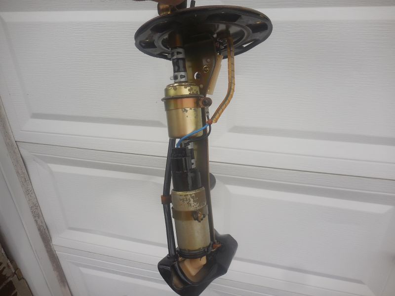

| Ok folks, I'm back with some findings. The fuel pump test was successful. Plenty of fuel came out when the ignition key is on the ON position. The spark is good. Then I decided to drop the gas tank and change out the filter and dispose of the old gas. See photos below of the tank and fuel pump assembly. It took me a while to drop the tank and it needs to be sprayed on the outside with some rustoleum because it's starting to get rusty. There is also some rusty spots on the inside of the tank as well.   |

I changed the fuel filter and flashed the fuel tank and that seemed to take care of the starting issue. Of course prior to doing all that, I had replaced the battery with a brand new one. And also replaced the plugs with new NGK plugs. I took the bike for a long ride and I enjoyed every minute of it on a gorgeous fall afternoon on the outskirts of Philly.
