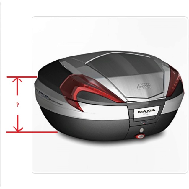

Guys, if any1 owns Givi V56 Maxia 4 (or 3) case, could you please take a measurement from the case bottom up to hinge level? 'd very appreciate it

If the backrest and top box mount are bolted flat on the spoiler - no spacers or risers - the Givi box lid will open so the lid is at least at right-angles to the rim of the bottom half of the box thus ensuring complete access to the interior.
In addition, the factory-fitted plastic restraining strap allows the lid to open to that point only.
I have had the identical set-up on three Silverwings and found it most satisfactory.
