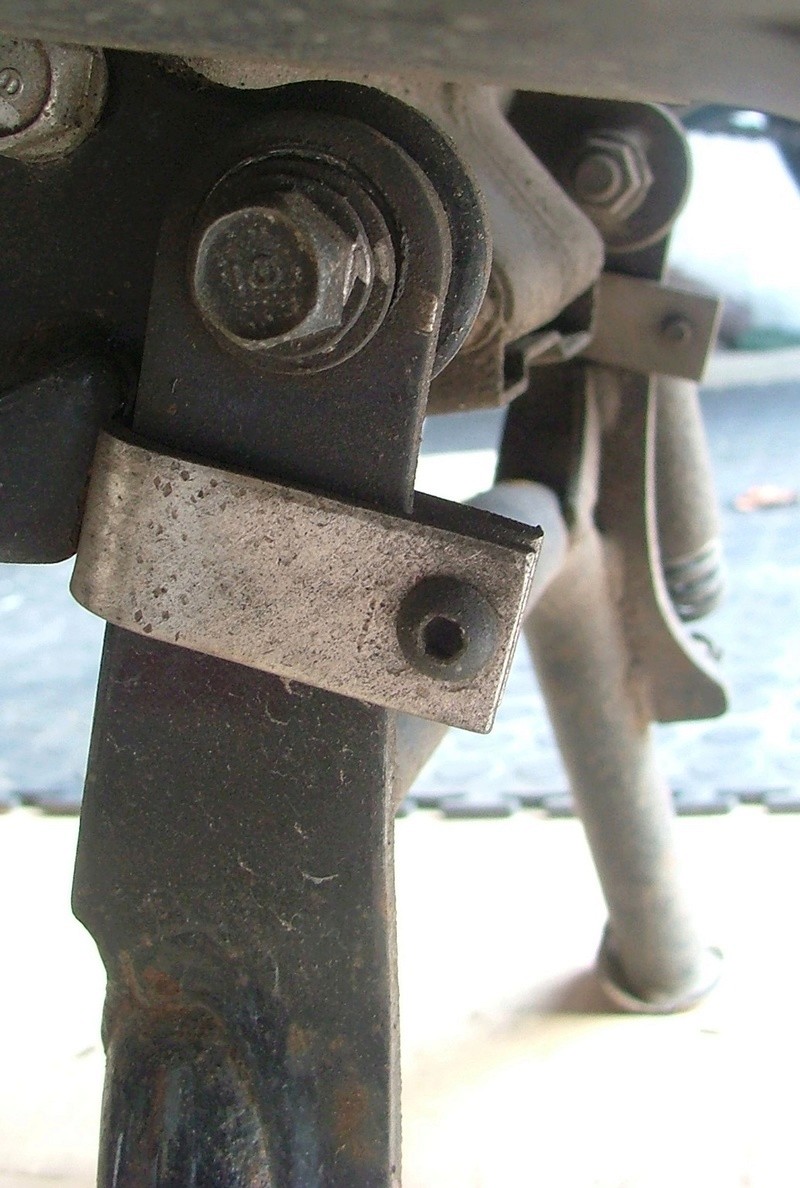

Pictures below. I think a cutaway would be more useful though. The silver metal brackets are there to restrict the forward movement of the centre stand, and hold the bike a bit higher to allow the rear wheel to clear the floor once it's been jacked up.
On the shock the alloy above that little groove half-way up the base is where I added the spacer.
