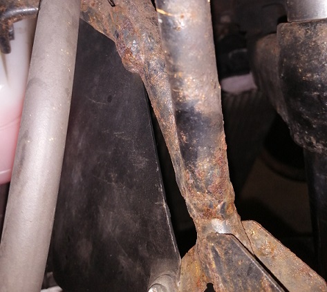

| I'm looking for some advice on corrosion inhibiters. Here are pictures of the front frame members on my SW. This is the LH side. ![Corrosion abatement product. Front_19](https://i.servimg.com/u/f94/19/66/09/85/front_19.jpg) This is the RH side. ![Corrosion abatement product. Front_21](https://i.servimg.com/u/f94/19/66/09/85/front_21.jpg) The steel is still intact and this is surface rust so I want to give it some 'simple' treatment. If I rub down the excess rust, would this ACF50 act as a suitable coating to keep out any further damage? |

| AFC50 is the only product I recall being mentioned to address the nasty consequences of UK highway maintenance. I guess it might be time for a serious wire brush massage followed by an AFC50 lathering. I’d also check that frame joint behind the pillion foot peg mount. IIRC that location was known to develop a stress crack on early model FJS600’s. So frame corrosion wouldn’t be too improbable. |

| Wire brush and AFC50 it is then. I'll take a look at the rear foot peg mount areas while I'm at it. |

| You should also consider a rust converter/reformer for dificult to clean treat areas on "Steel Parts", followed by your favorite paint and then a Corrosion Preventive Compound(CPC), rust converters chemically treat, seal and prime surface, must be painted or coated.
I can tell you with certainty with aprox 40yrs in aviation, that removing or chemically treating "RUST" or "Corrosion" is the best way, most spray on CPC products like ACF50, CRC, LPS3, etc are effective, but temporary, they are easily rubbed or washed off, must be re-applied periodically, in aviation they are basiclly the last product applied to metals after paint, etc. and are usually re-applied at major maintenance visits.
BTW none of these CPC are cheap, ACF50 13oz spray $20+USD, etc. |

| POR 15. 3 step process clean, degrease and brush on. $77 US. ![Corrosion abatement product. Por10](https://i.servimg.com/u/f51/20/33/45/83/por10.jpg) |

| Brush off the loose stuff then a good coat of Hammerite to sort out the rust. ACF 50 goes on afterwards to perform a protective layer of oil and road grime. |

| I'm really dealing with damage limitation here. My days of chemical treatments and nice shiny smooth paintwork are over. Those heady days of 'Rust-Eater', 'Anti-rust Primers' and shiny smooth 'Hammerite' paints just made my arms and fingers ache like hell!
There are some bolts and screws tucked away under that cover so I'm going to make sure they're not seized or damaged and then oil 'em up before they go back. One in particular is the bolt which holds the front brake pipes against the front of the fork yoke/stem assembly. It's in the line of fire for water, grime and salt and if it sheared off then fixing it would be a real PITA. Mine came out, but the head and shoulder were corroded so I had to be extra careful.
BTW, do these corrosion abatement sprays (like ACF50) dissolve grease and/or oil? |
