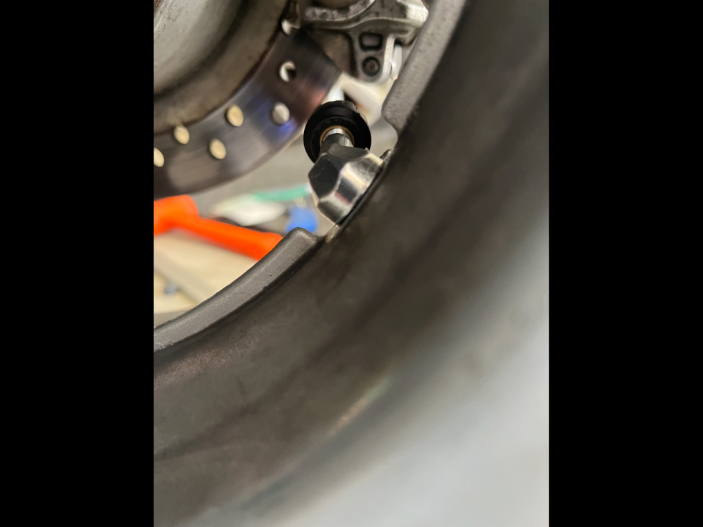

So, to resurrect this old thread; I had this happen to me this afternoon as I went to leave from work...
rear tire/wheel valve failure Img_2024rear tire/wheel valve failure Img_2026rear tire/wheel valve failure Img_2025
What a Monday! I had just checked the tire pressure before my 15min ride in this morning and seemed all good 36psi. Then this afternoon went to pull out not even 5mph while turning from my space and felt wierd when I couterweighted and then scraped the center stand into the pavement before I stopped. Just glad it didn't happen on the bit of highway I drive!

Good grief, how did that happen? The tyre has unseated itself from the rim.
Number of posts : 1301
Points : 3811
rear tire/wheel valve failure Empty
PostSubject: Re: rear tire/wheel valve failure   rear tire/wheel valve failure I_icon_minitimeWed Aug 31, 2022 4:18 am
I'm itching to find out what happened. Did the valve give up in such a way that the tyre deflated in an instant, or was the tyre flat before you set off?

Well got an update for y'all. I got it towed through my insurance to the house mostly because it was so late and the Honda Power sports dealer had no tires for me anyway. Which I found out just how heavy our SW's are when trying to roll it on a flat tire. Anyway, I got a chance to give it a good look over today and found that wheel wasn't chewed up too bad at all, I saw no damage to the tire or valve. So I figured what the heck...replaced my valve core, soaped up the bead and put my heavy duty roadside truck tire pump on and the bias ply bead set back up just fine. Inflated the tire, and got out the soapy water, no bubbles anywhere. Inflated the tire to 36psi as recommended for someone my stature, and rode it through the neighborhood, still holding, so still good? Probably?
One thing I noticed was the valve core was long, and my replacement seemed a touch shorter. Also, I remember it didn't have a cap when I bought it, which I finally put a cap on when I checked the pressure that morning of the fateful day. So, maybe it leaked because of the core/cap combo for my 8hr shift. I just didn't notice when I glanced and when I sat on it, seemed it's normal sponginess for me (6'5" 280lbs).
I'll have to check it in the AM and probably take the back roads 25-35mph to work and see.

I figured this is as good a place as any to discuss tire valves (vs starting a new thread)…my SWing is now 20 years old and I’m not sure if I’m on the original valve or not since I’m the 3rd owner of the scooter. I have TPMS monitors on my wheels (still check the pressures before a ride, but like to monitor pressure in event of progressive loss from a puncture). Anyway, I was using the TPMS sensors on the OEM valves (I know, a big no-no). Anyway today’s project was to remove the existing valves and replace them with 83 degree metal valves so I can use my TPMS and not worry about a valve failure.
For the front wheel, I had to take the wheel and tire off the bike as I couldn’t squeeze the one bead off the wheel so I used my tire machine for that:
rear tire/wheel valve failure 728d6d10
Once I got access to the old valve posterior, I cut that off, cleaned the hole and installed the new one:
rear tire/wheel valve failure B451f410
For the back tire, I was able to squeeze the bead off with a couple of hand clamps and a little help from a tire iron:
rear tire/wheel valve failure 3b6e4210
Since the little metal T of the rim interferes with the valve facing right (and it needs to in my case since I’m using TPMS), I used a Dremel and a sanding wheel, taking my time and filed it down just enough to allow the installation of the new valve, so there is clearance on top of the ‘nub’. TPMS clears just fine as well, so if you want to do this installation, it’s not very difficult (and I’m sure you could use the clamps as I did to break the bead or use a large C-clamp to break the bead). I can ride without worry now.

Is the above pic from your rear tyre?
I have always changed to alloy valves in combination with the TPMS. However we swapped the valve around to face the other way, as it is nearly impossible to fill up with air with the valve facing toward the disc brake. Just a thought. Smile

I did a lot of reading here and suspected the tpms monitor would strike something on the left side of the rear wheel if I faced it to the left. It’s still necessary to get on the floor to fill the tire but not really all that difficult.
I would just have to break the bead again (not that difficult) loosen the nut on the valve and turn it to the left…not that hard to do. Can anyone confirm it’ll fit the other way (without any sanding of the metal on the back of the tranny housing, etc.)?
