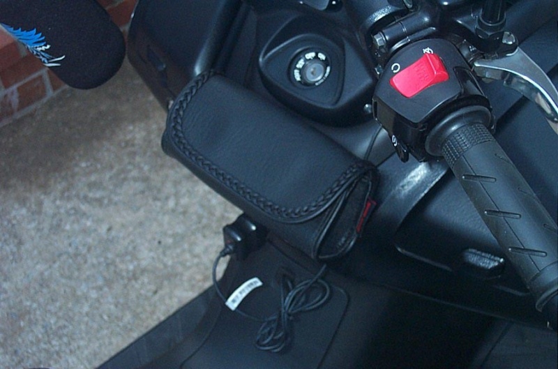

Hi All,
Just finished installing a small storage bag on the Swing. I'm sure this bag will come in handy for sunglasses, light summer gloves, or what ever. I don't know if anyone has installed one like this, in this location. It seems like the perfect bag and place for mounting one. Used 2 corse threaded screws with 2 large fender washers.
I purchased this bag off of Ebay for the amount of $16.00 USD and it can be found online. It's manufactured by company called River Road # 10-7729 (with braid) # 10-8933 (no braid). The dimensions are 8"W x 4"H x 2.5"D The bag is made to be mounted on the handel bars and comes with 2 small straps, I did not use, but will use for other things.
I drilled 2 small holes 1/8" dia, 4.0" apart, centered on the removable plug (or 2" each side from plug center), and determined the location of the 2 holes in the bag by stering clearence requirments and used a small leather hole punch for the 2 holes in the back of the bag, this worked well.
Handy Storage spot for SilverWing Bag110
Handy Storage spot for SilverWing Bag410
Handy Storage spot for SilverWing Bag310
Handy Storage spot for SilverWing Bag610
Ride Safe......Dennis

The bag is interesting...BUT...I'm more interested in the power outlet below it!! Handy Storage spot for SilverWing Icon_smile
I read the thread about the left glove box but that just doesn't work for me. Are you supposed to ride with GPS capability & have the lid flapping in the wind? Did anyone do this? Did you notch & grommet the lid?
I like the Master's idea about it below the handlebars MUCH better...
