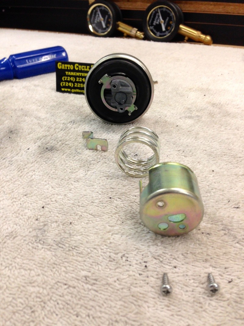

NWSSC wrote:
I found the locking gas cap to be a pain in the tank.On our 4,500 mile trip to and around Colorado I removed the little locking device from the cap.Take out the two screws from the bottom of the cap,remove the cylinder and the little metal dog locking mechanism and put in a plastic pill box(need I tell you my age) and store it in one of the glove boxes, reinstall the cylinder and your set to go. Have not had any problems in 45,000 miles.
Why go thru all the fuss and money hunting for a replacement cap, Just remove the dog and save it if you ever want to restore the lock to normal.
