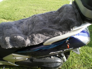

Here ya go, the slope where the slits show up thats where the bumps are.
Modified Three Brothers Performance Backrest Seat111

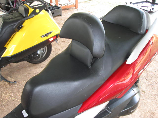

here are some of my rug
Modified Three Brothers Performance Backrest Seat311

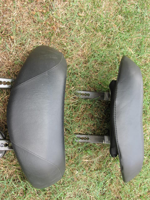

Not the best of pictures but hope you get the drift of what I'm trying.Modified Three Brothers Performance Backrest Seat410
Can be adjusted forward
Modified Three Brothers Performance Backrest Seat510
I believe an Airhawk or anything that would raise up the seat (under your sheepskin) would help you to resolve this problem.
Do you have anything you could temporarily put under your sheepskin for a simple test? If not goto Walmart and purchase the gel seat cushsion, after you are done you can return the gel seat cusion. You could test with a single gel layer or fold over for a double layer to see if either would resolve.
This simple test would let you know if some height would resolve your discomfort. If it does you can choose later what you would like to have under your sheepskin.
