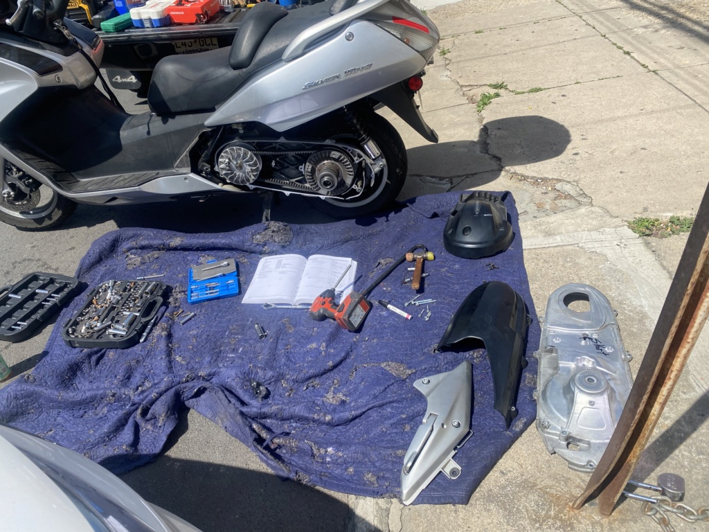

Picked up a 2004 silver Silver Wing last week. It came with nice extras like a new Honda belt, new Malossi variator + rollers and new Malossi clutch.

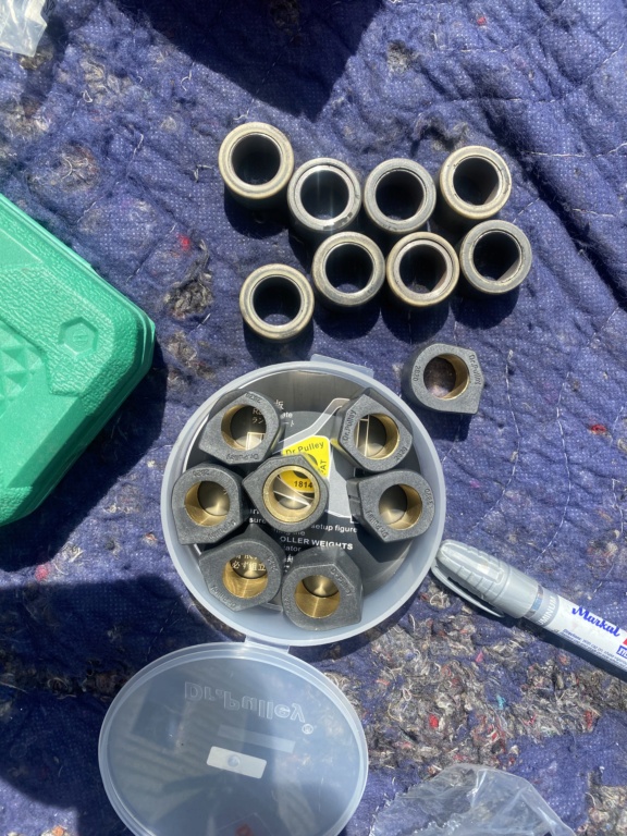

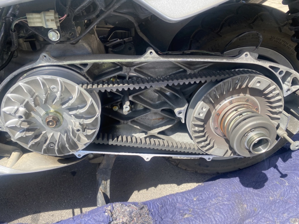

I cracked open the CVT case last night at 21,700 miles. Definitely needs a belt. This one is original. I've done several Silver Wing belts and rollers/sliders so I'm fine with that (a sturdy universal variator holding tool also came with my purchase). I am thinking I'll install the Malossi variator and 24-gram rollers.
However, I never did anything with the clutch on a Silver Wing and that's my question. Or questions:
From reading this forum, it looks like I can engage the parking brake, loosen the nut and pull out the entire clutch assembly to clean and sand the pads with Emery cloth or fine sandpaper if needed. First question: is that sentence correct?
Second question: as long as I have a new Malossi clutch, is there an easy way to swap it out with the OEM? Four or five bolts? I don't have any special tools for the clutch, and with no experience, I am looking for "easy" or I simply won't install it. eBay is a good option.
(NOTE: I have a separate post offering these and other Malossi goodies for sale. I had a full price offer but the guy said his other bike just cost him $1,000 in surprise repairs so he backed out. Next best offer was $250. Nah, that's an insult. I may as well keep it all, enjoy enhanced performance and add to the value of the bike if I sell it. Tim: if you still want the white Malossi torque spring, I will mail it to you, gratis, in appreciation for the help you provide to so many here. Just PM me the address)
Thank you in advance for info and insights.

PostSubject: Re: Clutch Question   Clutch Question I_icon_minitimeSun 12 Mar 2023, 12:57
Hi Delray.
In answer to your first question, the sentence is correct, once you remove the drive belt. I would also emery the clutch bell.
Second question, just remove the 6 bolts holding the OEM clutch on and swap for the Molossi fly, if the bell is not to badly scored(obviously a new bell would be preferred with a new clutch, and special tools would be needed to swap bells).
There are plenty of alternative ways to remove the bell without the OEM tools, just search Clutch tools in the search bar.
Hope this helps you....

That Driven Pulley nut is only torqued to 40 lbs ft so it's easy to remove. If the parking brake doesn’t hold tight enough you can always zip tie the rear brake lever. Easy peasy.
I’ve flipped the Driven Pulley over and held it in a Workmate “vise” to remove those 6 bolts holding the clutch assembly.

Avoided a likely dealer tab today of $1,200 to $1,500 and installed a new Malossi variator with 24-gram rollers, new Malossi clutch and a new Honda belt.
Job was straightforward and made easier with good info and tips from this forum. Great feeling to start the bike and see everything running beautifully. Took it for a short test ride but I'll give the new belt 100 miles to get settled in before I push it to see what the fancy Italian parts can do.
