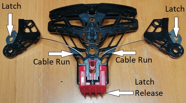

I have an AGV COMPACT ST flip-face helmet and the latch has seemed a bit stiff and awkward to lift up, even without gloves on.
I had a look inside and here's what I found. This is the opening mechanism shown as if you were looking at the helmet face on. I imagine that most helmets work in this way:

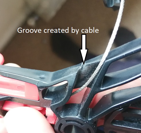

Naturally, the cables will create a groove in the plastic runners:

I applied silicon grease in all the plastic friction areas and now the face lifts up nice and smoothly. I can't do much about the grooves but I hope the grease will slow down the 'sawing' motion.
It's not the discovery of the century but I thought it was worth a mention. I suppose helmets in the upper price range don't suffer from such ailments.

I would be tempted to try to Araldite a piece of cut up soup tin as an L shape where the cable is biting into the plastic cable run, certainly worth the effort.
Also AGV can supply replacement parts for some of their helmets range, again worth a phone call.
Hope this helps you.

Thanks for that. I like the helmet and it would be a shame if it became unserviceable because of a bit of worn plastic. I suppose there's some life left in it yet.
