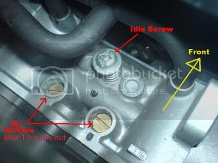

The choke is an enrichment circuit opened/closed by a "Fast Idle Wax Unit" that's coolant heated to close passage, besides checking for bad vacuum hoses, etc.  Check/count turns on air screws, sometimes air screws are turned by accident, affecting synchronization, and/or too far out, a good general setting for both airscrews is 1.25 out to a max 1.5, if set over 1.5, it could affect the fuel press at idle and/or fast idle operation when cold or even TPS idle position setting slightly. Because the idle screw was used to compensate for other issues it changes the throttle plate position and/or vacuum signal to regulator.
If you have the means to synch. air screws do it, but is not very critical IMO.

Low idle on cold start Carbsc10
This is what I am talking about, that is a lot of good information. Does the "Fast Idle Wax Unit" ever go bad? I haven't had time to check any of this out yet, but what is the best way to access the air screws and vacuum lines? Under the seat near the intake or the little hatch below the seat?
Thank you for this information and pictures.

I rarely see my tacho showing a regular and constant idle speed. It's lived with it for 6 years and it's never been an issue.
Once warmed up and then waiting in traffic etc., it's usually around the 1100/1200rpm mark which I consider to be about right.
The RPM's get really low, but not sure if it will stall as I have always kept it running by applying some throttle.
