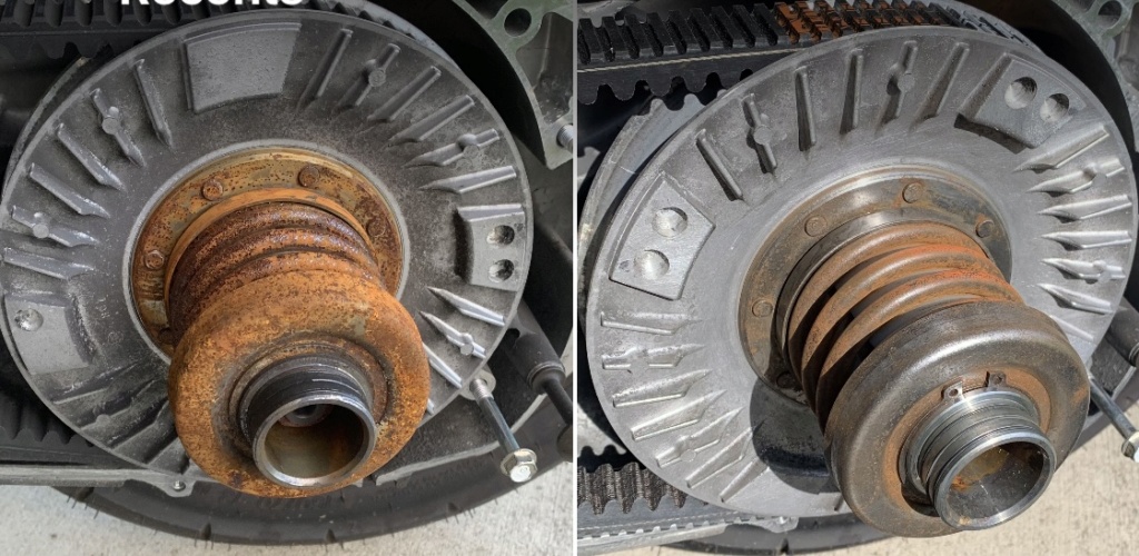

Also as routinely recommended here, install new tires, change the motor oil and filter, the air filter, rear drive oil and brake fluids.
And install a new cvt belt. I used a GBoost and while I was in there installed 26g Dr. Pulley sliders.
And while you have the cvt cover off, examine the whole drive train. My driven clutch assembly was badly rusted but it was superficial and cleaned up after wrapping rags soaked in EnviroRust liguid around the assembly overnight then scrubbing everything with a wire brush:
Help me!!!! I need advise!!!  crazy story A3af9810
The only thing I had the Honda shop do was inspect it, install the tires and completely rebuild the front forks, one of which was leaking badly. Again, I’m no mechanic and didn’t want to attempt rebuilding the forks and installing tires. Everything else I was able to do after asking LOTS of annoying noob questions and watching numerous videos.

There ya go!  ZXR212's illustration clearly shows a 3 pin wire harness connection plug. So locate that plug, disconnect it, then use a paperclip(s) to bypass the ignition switch and make the connection. No wire cutting required.

The story I'm getting is that an older gentelman loved his silverwing. He rode it alot. He then fell ill and passed away. He had a friend or brother that would come and start it up and maybe take it on little rides. So while it was "sitting for several years (9-6) I believe there was a few times in between that someone would start it and let it run. The niece is now preparing the house for sale and needed it gone. I don't believe that it has been started in at lease 5 years. Long time. I have removed some of the pieces and the handle bars. I am not getting power to the ignition connection. i will spend some time on it this weekend. My hope is to see if I can get it started by jumping the wires. If that works, then I will invest in a new switch or a toggle switch and put it in the lockable left glove compartment. Or maybe try to get the key out of the ignition once I have removed it. It is really stuck in there. Thanks to all of you for your comments, please keep them coming. I need to find out where the power is getting cut.
