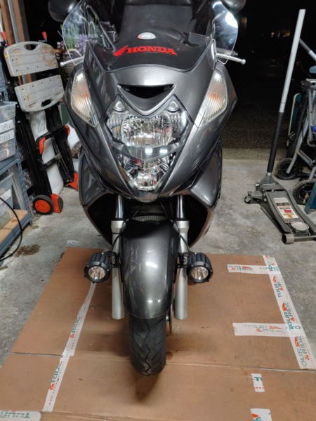

| Ok, so don't laugh. I put leds on the forks. They are bright as all hell, but could be contributing to the wobble. I am thinking just taking them off.  |

| The wobble you describe sounds like wobble and weave (it's down to the laws of physics, lots of good stuff on Google explaining it). If the bike wobbles with a hand or two on the bars you have a different problem. I wouldn't start throwing money trying to cure the incurable.
Those lights down there aren't a good idea though for all sorts of reasons. Expect them to create problems at higher speeds and or windy conditions - even with hand on the bars and an open throttle.

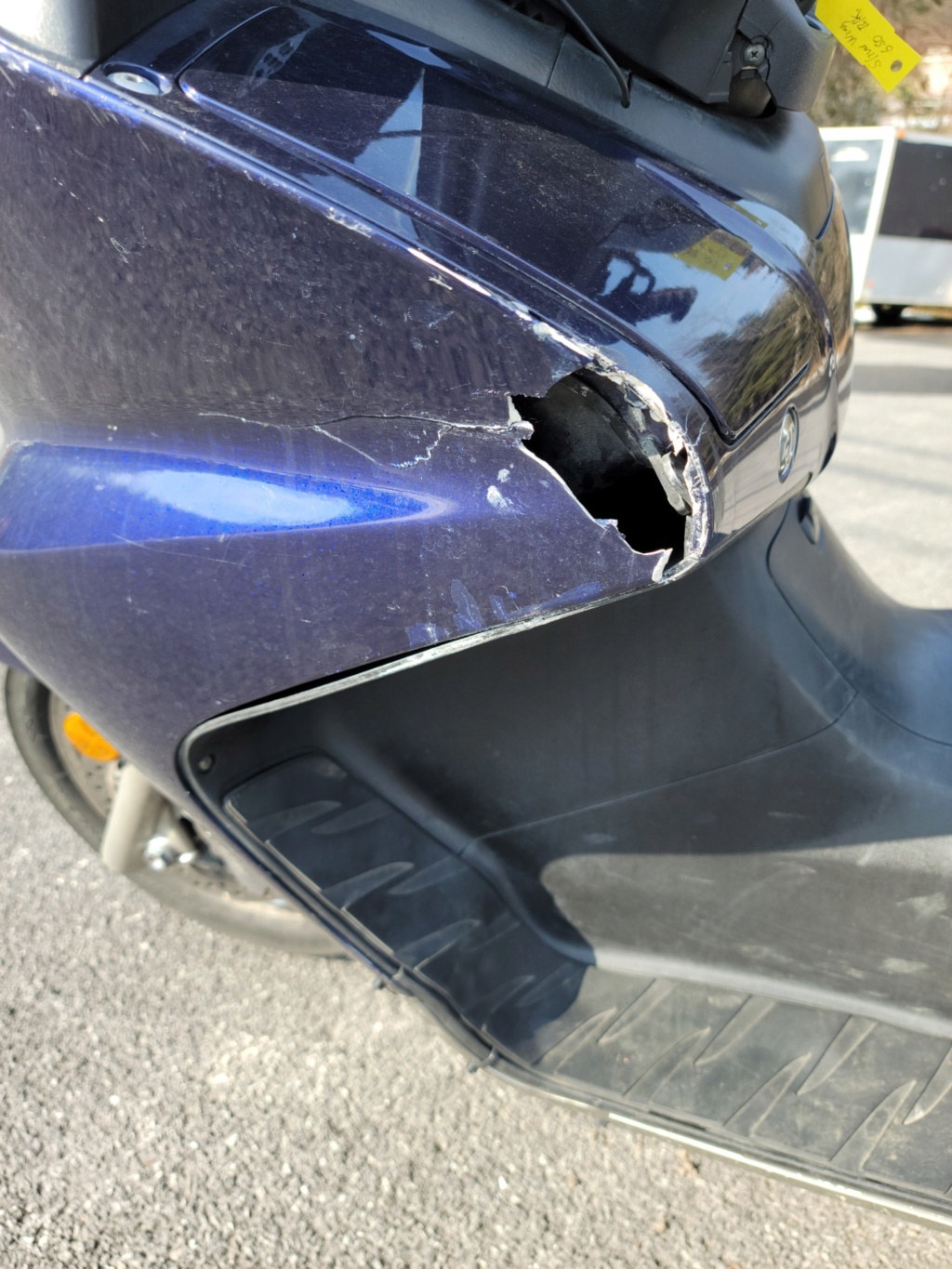

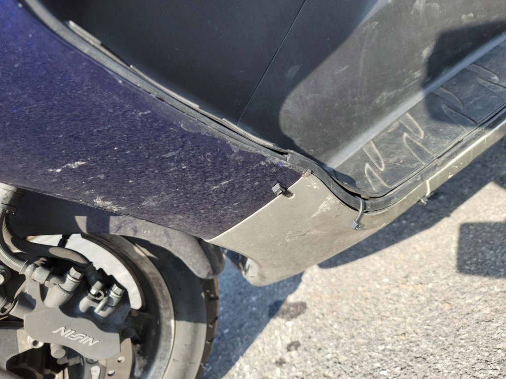

| OMG Mech 1, that's an ugly one. Can't believe a dealer is trying to off that. |

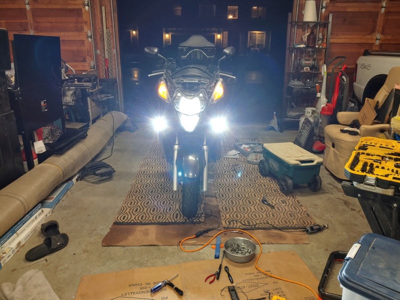

| I moved the auxiliary lights from the front fender to the fairing. I also installed LEDs for high and low beams. Extreamly pleased with the results. The LEDs are a lot brighter and look more modern.  |

| - TheDude wrote:
- I moved the auxiliary lights from the front fender to the fairing. I also installed LEDs for high and low beams. Extreamly pleased with the results. The LEDs are a lot brighter and look more modern.
 Any chance you could share a bit more details. Maybe also a few photos showing how you went about relocating the lights. Really looks good. Thanks. |
The Dude Maxi-Scooter Rider
Number of posts : 195 Location : Lake Stevens, WA Points : 625 Registration date : 2022-02-20
 | Subject: Re: Might have bought the wrong SWing. Sun Mar 20, 2022 7:41 pm | |
| - Benzon1960 wrote:
Any chance you could share a bit more details. Maybe also a few photos showing how you went about relocating the lights. Really looks good. Thanks. Yes! Absolutely. I will get a couple pictures and an explanation. So, right now I have the auxiliary lights hooked up to the bright beams. However I have found the low beams severely lacking in brightness, especially in the rain. I think I will use the low-beam tap and just reposition the aux. lights to shine downward a bit more. It's easy to position the lights, just center stand about 15 feet from the garage door. So low beams, similar to a car, I will put the left aux. light forward and about even height wise with the main low beam. The right will be more to the right and down a bit to help see the shoulder. (for US style, it would be opposite for UK). |
 | Subject: Re: Might have bought the wrong SWing. Tue Mar 22, 2022 1:56 am | |
| - Benzon1960 wrote:
 Any chance you could share a bit more details. Maybe also a few photos showing how you went about relocating the lights. Really looks good. Thanks. I made a new thread with more details here: https://www.silverwing600.com/t12567-aux-lights-led#128286 |
