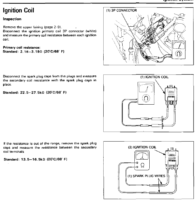

PostSubject: Re: My Sliverwing wont run   My Sliverwing wont run I_icon_minitimeSun Jan 30, 2022 12:22 pm
OK tested the coil its not right so order a new one. But I did forget to take a photo of the wiring so now i have 2 wires one yellow the other black. On the coil it has a green pin and black. I look in the service manual and i cant see where it has the wire colours and what pins to attach to eacjh colour. I think its yellow to green pin and black to black.
Number of posts : 1301
Points : 3811
My Sliverwing wont run Empty
PostSubject: Re: My Sliverwing wont run   My Sliverwing wont run I_icon_minitimeSun Jan 30, 2022 2:07 pm
Are these the ones you mean?

thanks loosemarbles for photo will have new coil by weekend
