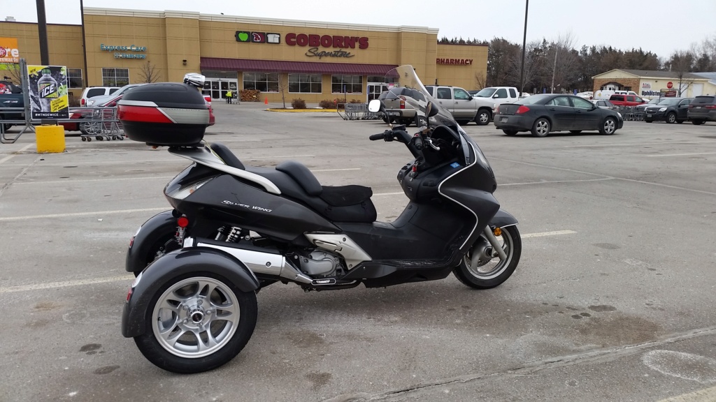

|  This is my converted SWing. It has a Motor Trike conversion kit on it. Motor Trike makes the kit then sends it to a dealer who's qualified to install it then the dealer does the installation. I'm old so forgive me but I think I've had this on now for three years and have no regrets. It's a bit of a learning curve on riding it but once you get the feel of it it's a piece of cake. Intersections and round-a-bouts were the tricky part. You don't lean into the curves and at first that feels funny or weird. I rode it around town for about an hour or so just to get the feel of it before I tried the highway. And it only has two wheels on the back. 14" X about 6" wide so it's a true trike. It cost me about $8,000 total for the kit. That's making, shipping and installation. For me it was money well spent. In town I've lost a bit of mileage but on the road it's only been 2-3 mpg. It still has plenty of get up and go too. Also, to your question about anyone selling a nice triked SWing. Well Yes I will sell mine to you for the small sum of $100,000.00. I guess I really don't want to sell it tho... Sorry, I couldn't help it. Also, Motor Trike will let you know who in your area is qualified to do the installation. |

| Hi Dale:
Thanks for taking the time to share your experience. Might be worth my getting in touch with Motor Trike to see how far away the closest qualified tech might be. I'm wishing I had kept the cream puff 2012 that shows in my sig line (glad to have replaced that Triumph with a 650 Royal Enfield, though); it wudda been a perfect starting platform.

| Hi Pete, One thing I mentioned on that other topic, Mr. Dale A Question Or Two, was that when I had the trike kit installed I also had them put a 4 degree rake kit on the triple tree to extend out the front wheel a bit. A member of this forum, who's no longer on, told me to have that done for handling purposes. I guess it worked seeing as it handles real nice. |

| Dale good point on the raked front, do you remember the amount in degrees? I rode a G'WING with no rake, stock, lets say like no power steering compared to those with a kit. I question the tipping in those off chamber turns and normal road speeds. |

| Re that 4° rake. Did Motor Trike supply a new steering stem with the increased rake or did they alter your existing steering stem for the improved rake?  |

| I think they might have just altered it. Not really sure. Also that 300 mile chain lube to me is a bit much. I don't lube it that often. It's a good and heavy O ring chain. On my old 750 Honda I never lubed it that often. |

| Dale-- Could you give me the outside-to-outside measurement across the rear wheels of your Motor Trike S'Wing please?
I'm looking ahead to bringing one home on my smaller Chariot trailer, and would hate to arrive at the seller's only to find the scoot wouldn't fit between the side rails!

| Four Feet give or take an inch or so from tire edge to tire edge. Add 3 1/2 inches if your counting from the outside of the fenders. So 4' 3 1/2" fender to fender. Sorry I didn't get back to you earlier but I was helping my sisters at their new house. |

| Thanks, Dale. You just saved me a long trip to look at a trike only to find out it won't fit in my single-bike trailer. My Chariot is just over 3' between the inside walls of the fender wells. More than enough for a single, two-wheel motorcycle, but I won't be able to shoe-horn a Motor Trike puppy into it.
Looks like I do something about adding a single chock in the center of my two-bike trailer...or just pack some really warm riding gear and let the wife drive back alone in the car while I hide in her slipstream behind that nice Givi windscreen this one sports. |
